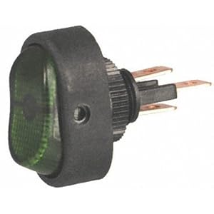

bumping this... so i have one of these switches..
how do i wire it to apply ground to the relay? this is a new concept to me. usually the switch is wired with a ground, 12v supply, and the lead to power the relay.

Bump again... When the white/green wire gets grounded it sparks and blows the fuse. That wire has 12v going through it. What am I doing wrong?
My electrical isn't the greatest but that probably isn't the best switch for completing a ground circuit, though it should work. Ground IN would go to the upper short terminal, ground OUT would go to the lower short terminal.
Normally that switch lights up when the circuit is completed where the hot would come in the top and out the bottom and the middle terminal would be grounded to allow the light in the switch to illuminate.

I figured the switch wouldn't light up, that isn't a big deal. But I don't understand why the wire I'm supposed to ground is hot, and when I ground it sparks out and blows the fuse.
