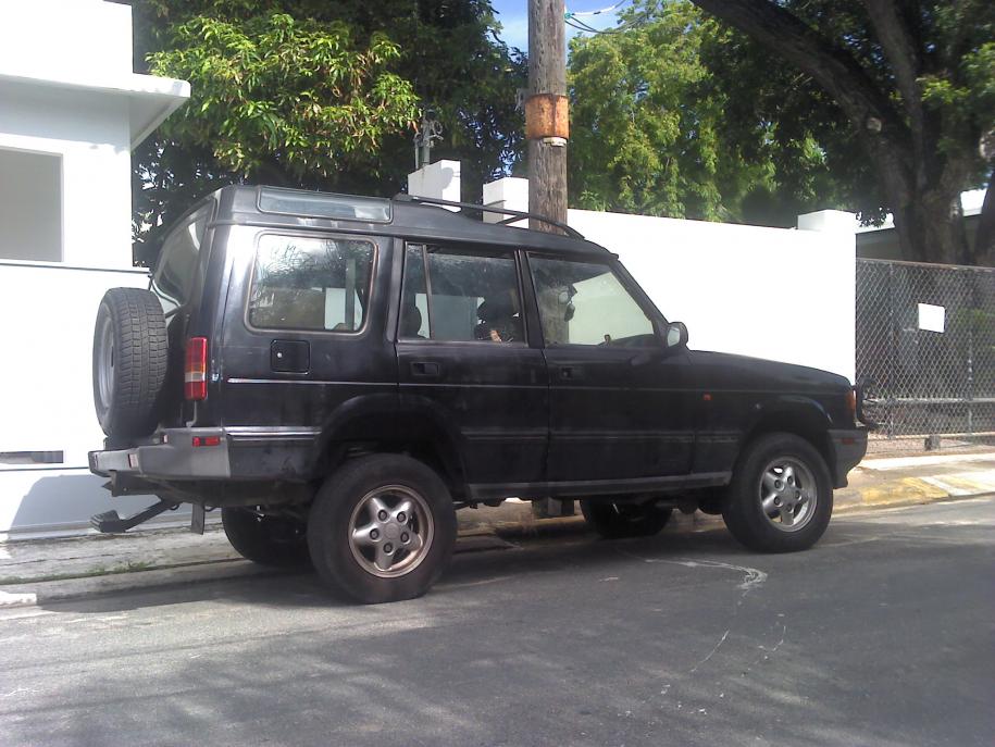

my mechanic put the front springs on the back and vice versa. the front was very high, even extreme. i didn't see it because when he was telling me i figured it out and told him to switch them. now the truck definitely sits higher in the back...a little hot roddish. I don't mind the look and for sure it should flatten a little when I put some weight in it. It's super light now...no soggy mats even. I'll do that same measurement for you this weekend. Stay strong. Mine isn't going great either.
Attached Thumbnails My 2" Lift install experience.-2011-07-20_09-06-22_674.jpg

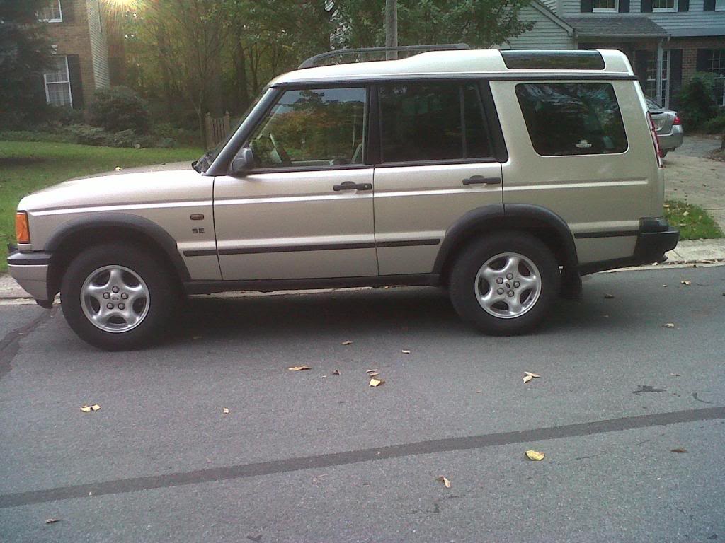

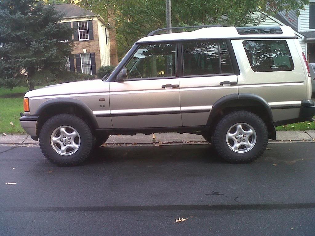

just installed the Terrafirma 2" kit with 275/65/16 Duratracs
BEFORE
AFTER
Now my steering wheel is cocked to the right - BUT the truck tracks perfectly straight. any thoughts as to how to fix this?
You have two options to fix that
1: get an adjustable panhard bar
2: adjust the drag link (rod from steering box to passenger side knuckle)
I would almost bet if you measure it your axle is slightly off to the drivers side now, its just the way a panhard rod suspension geometry is. Since you have a 2" lift you can get away with adjusting the drag link its easy to do if the ends arent rusted fast to the rod itself.
