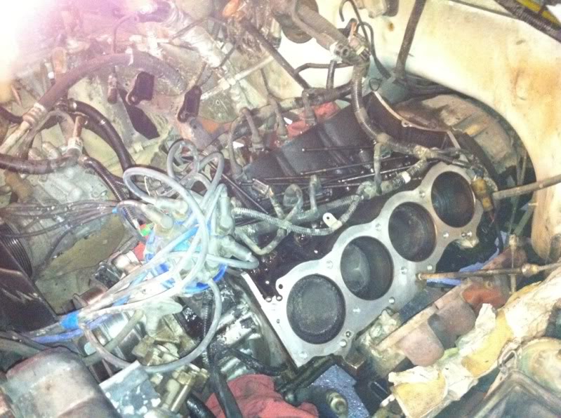

Here is about 2 hours of work!

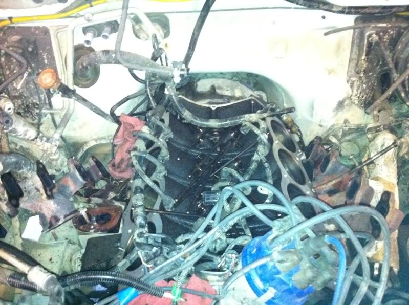

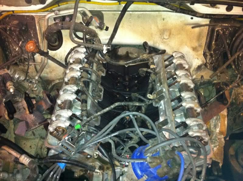

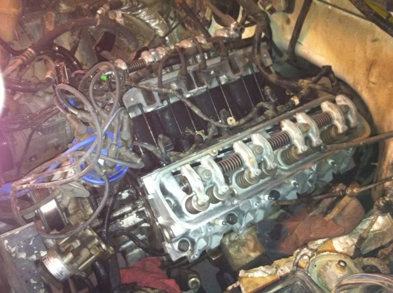

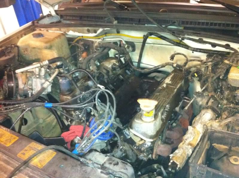

5 hours in and I am now a slave to the heat tank. Some NAAASTY sludge in my heads. Had to extract 4 head bolts with my turbo socket. Here are some pics:

Have to say I am behind schedule. Those 4 head bolts took me almost a hour to extract. I too have questions about some seals and where they go. Same as the other guys post. I have 3 sets of 8 seals and no idea where they go. I figured out the other gaskets.

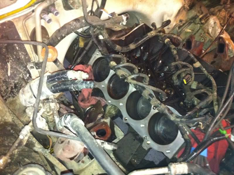

I noticed on the inside of the intake plenum it is listed as 3.9 and 4.2. Perhaps they are for the 4.2. I think I remember the Disco 2 having those bigger round gaskets in the intake. I wanted to get her done today however the sludge in the heads was too thick and took me forever to clean up. So I guess it will be monday. Progress at the end of today, heads back on:
