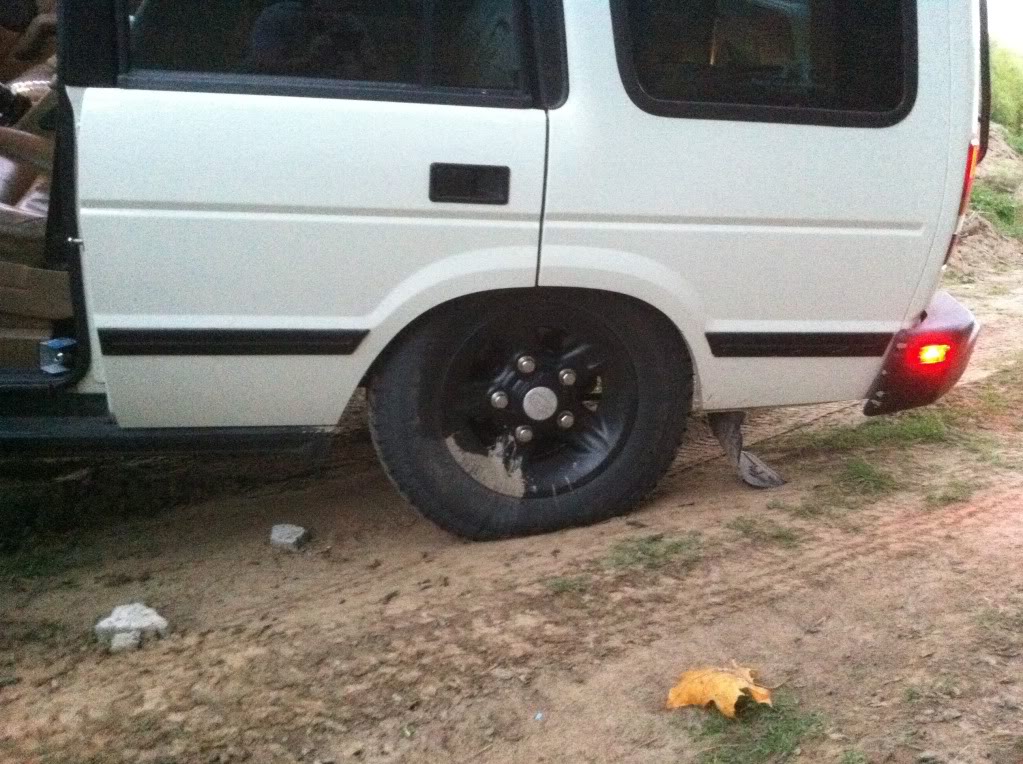

235/70 Stock Tire Size 2.5" OME HD LIFT

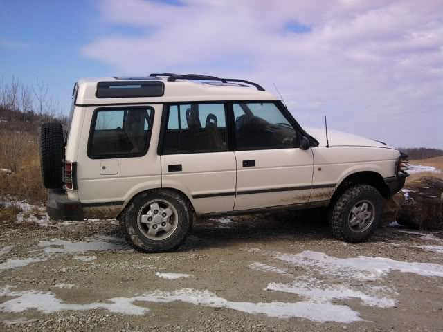

235/85 requires 2" lift heres a picture of them on OME HD
