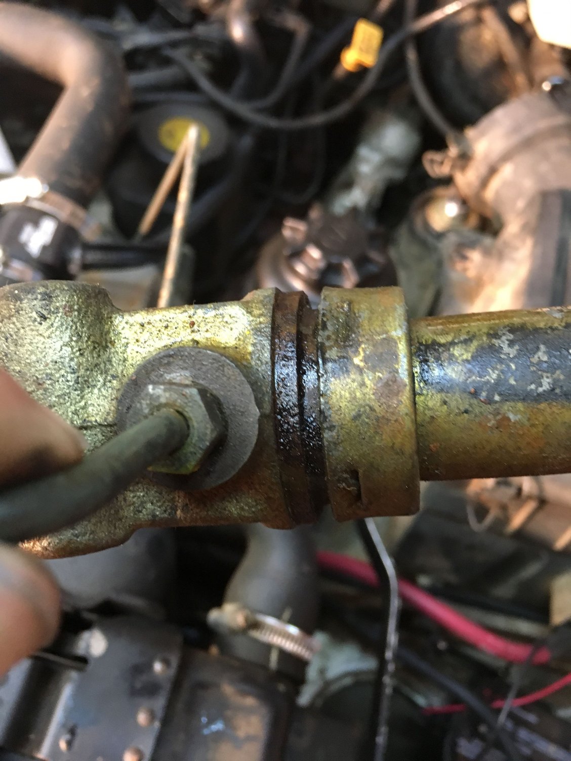

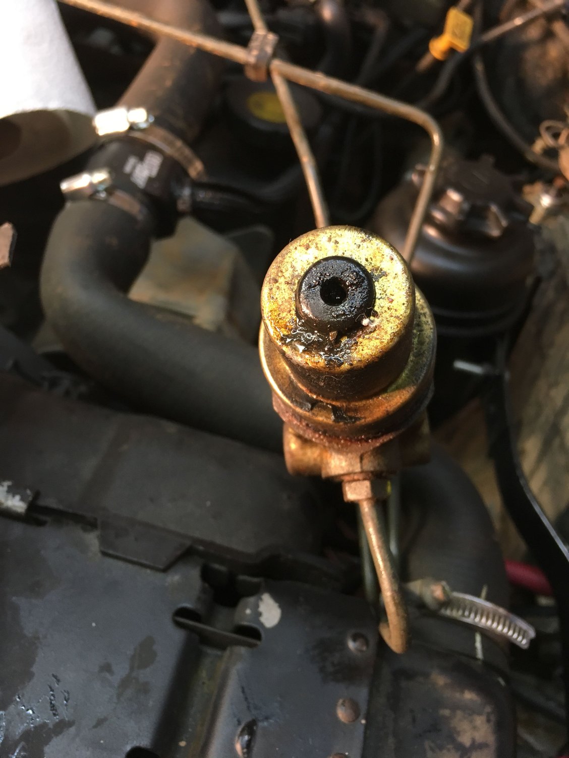

I pulled it and could not find any fluid at any of the lines but did see fluid on the back of the unit. Looks like a new one is going to have to go in.

Bingo! Dang good job man! Yep, new is in your future. Thanks for doing it, I'm sure you're not the only one who's gonna run across this. Whole bunch of others are probably gonna see it happen too eh. Wow is all I can say. That is blown out big time.
