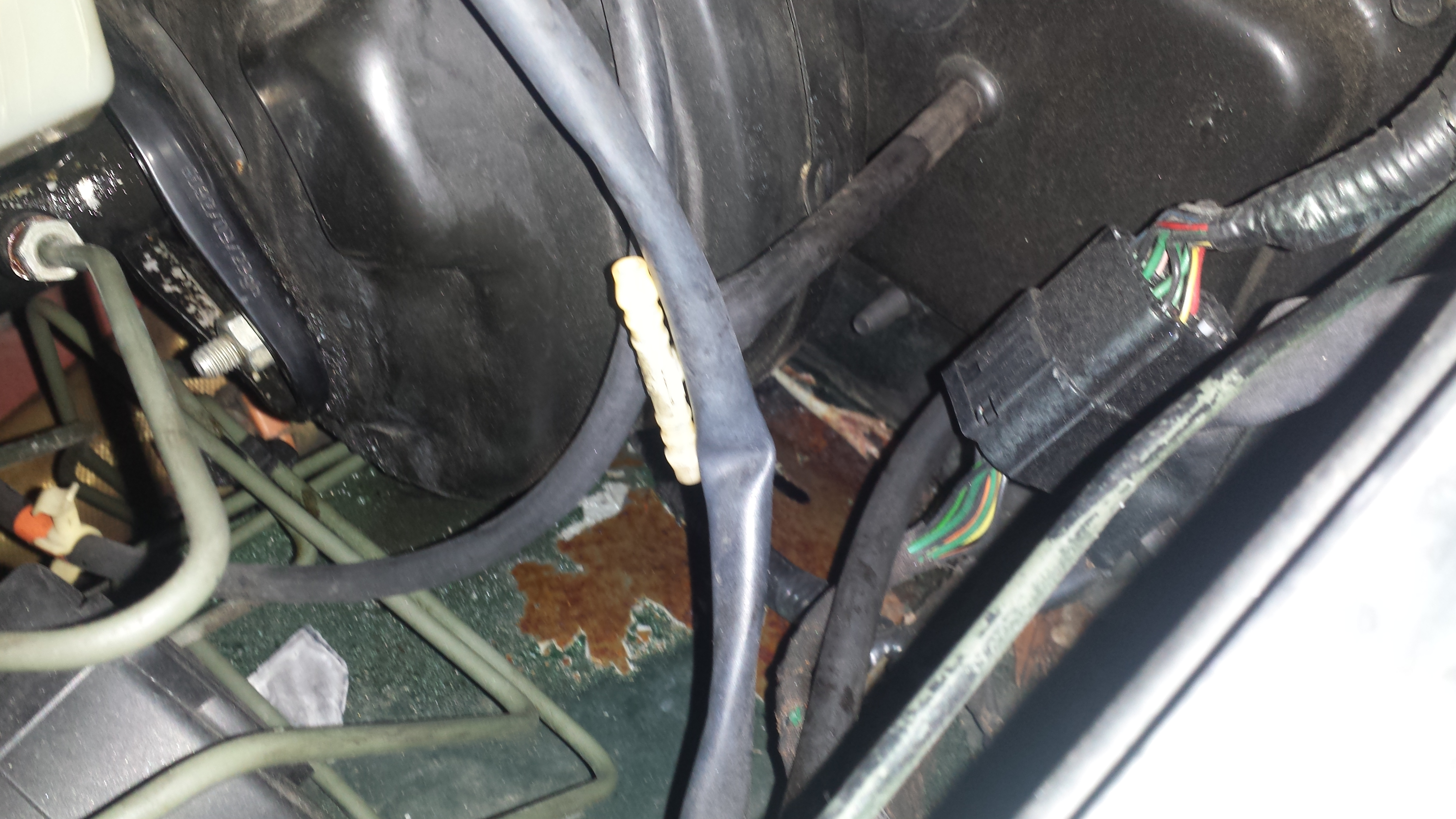

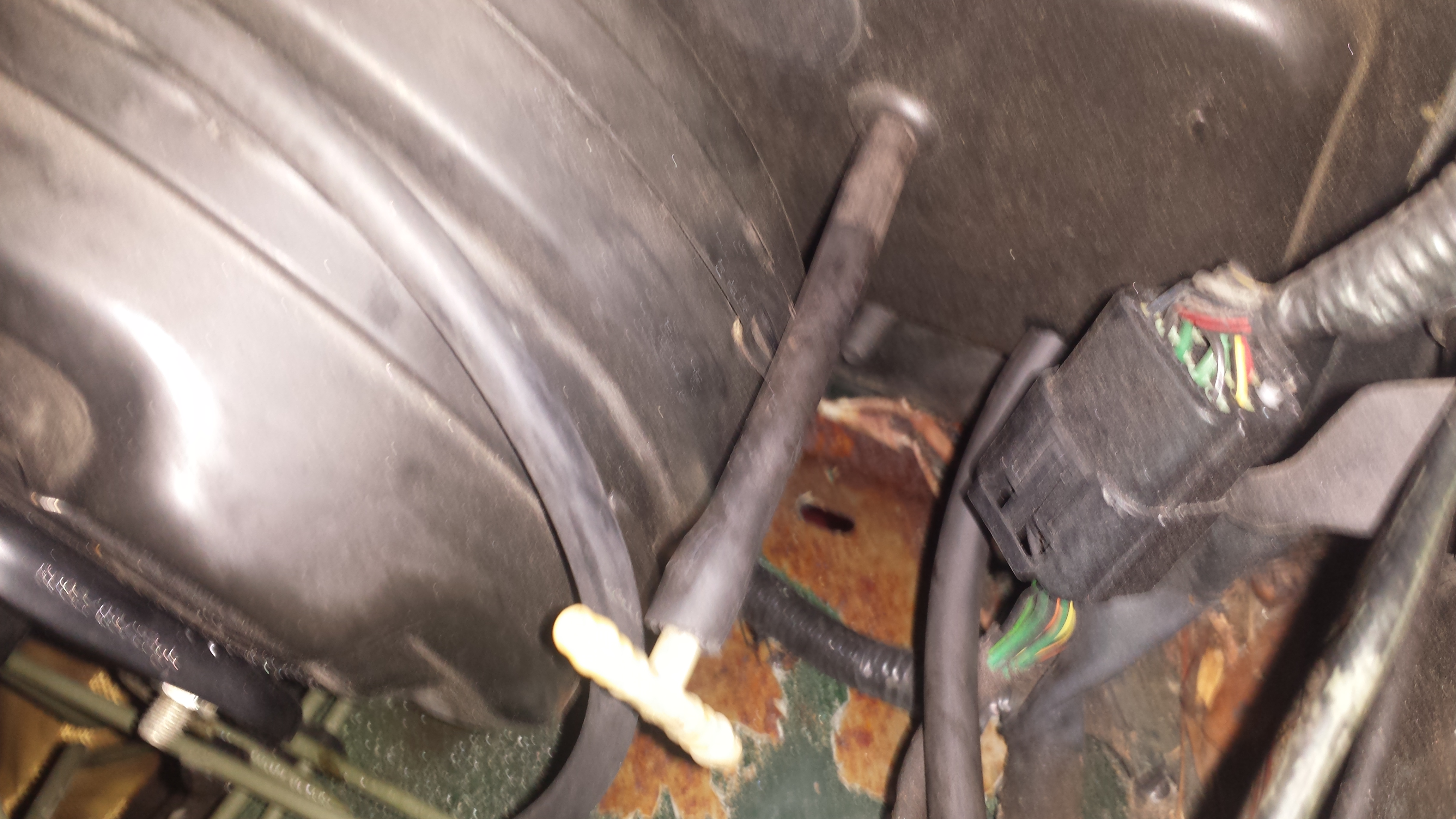

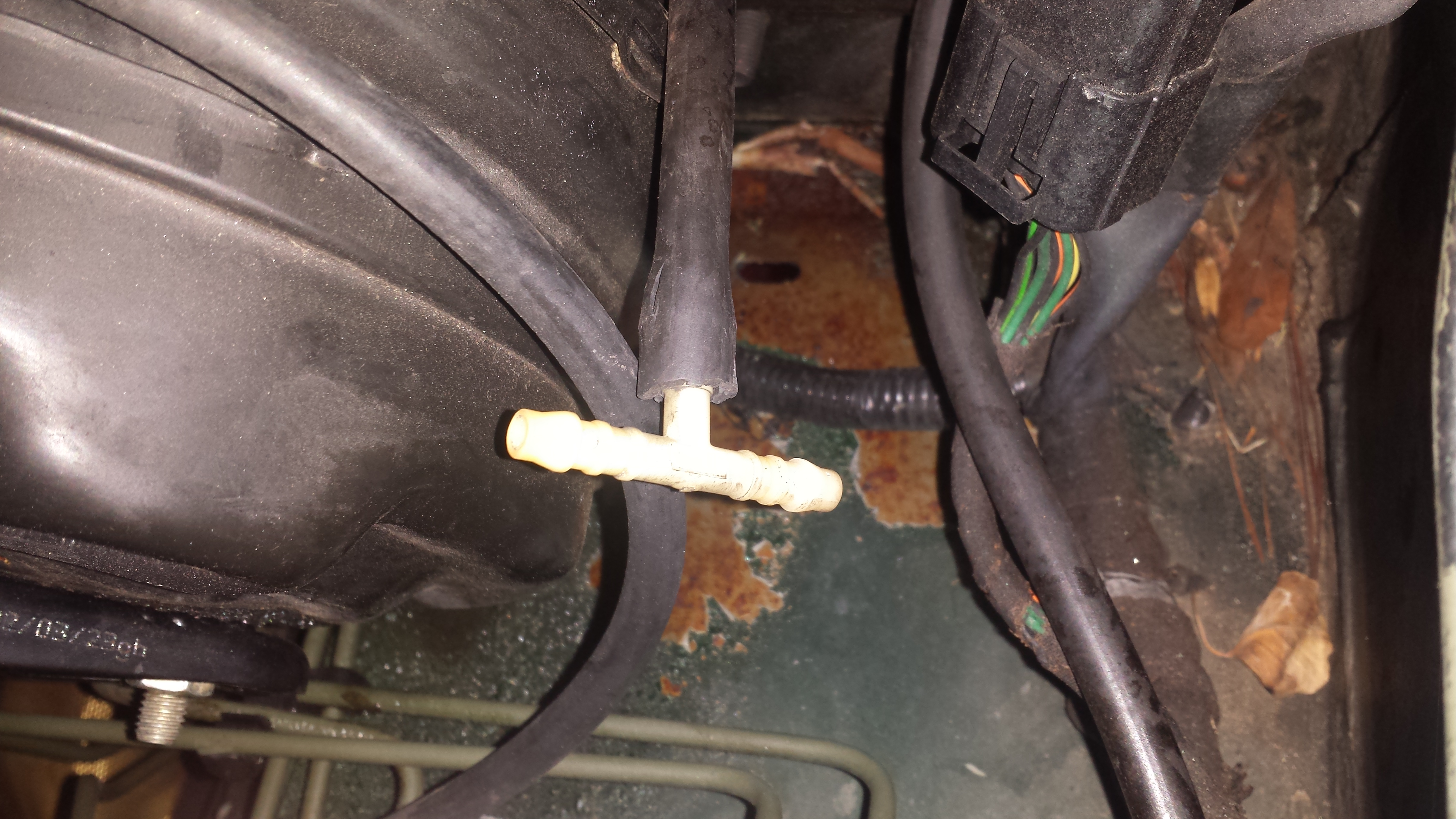

Hi All, please see the attached pictures. That yellowish T-shaped plug in the picture is now missing and I'm wondering what it was for. I don't think it is a vacuum hose because I checked while the engine was running.
Does anyone know what it is called and what it is for and where do I go to get another one?

cruise control vacuum line. the line that goes into the fire wall is for the brake vacuum valve. one side will go to the pump behind and below drivers headlight other to the rubber diaphragm next to throttle linkage

Zero effect on brake performance. The cruise control draws vacuum from an electric pump.
One end of the Tee goes to the CC actuator ( at the intake ) looks like > Cruise Control Actuator For Land Rover - Genuine Part /
The other end to the vac pump looks like > Cruise Control Vacuum Pump (PRC6260 Same Fit As Part # PRC6260 ) - Land Rover switches/control unit/actuators from Atlantic British
The middle hose goes to the CC brake switch located above the brake light switch on front of the brake pedal. looks like this > Switch Cruise - Control - Brake (Genuine Part # ERR2622 ) - Land Rover switches/control unit/actuators from Atlantic British
