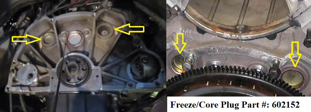

A '96 DI 4.0 has ( 8 ) freeze plugs, (3) on both sides of the block and (2) in the rear.

Yes, the freeze plugs are just pressed/driven in with a hammer and a seal driver tool(or impact socket).
Looks like this >
