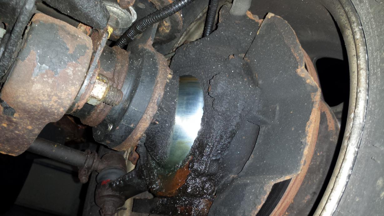

Here's a pic of that wheel ball joint

See that orange crap, I would pull the. Hub and stub axle make sure there is not water in there, looks like rust/water/grease

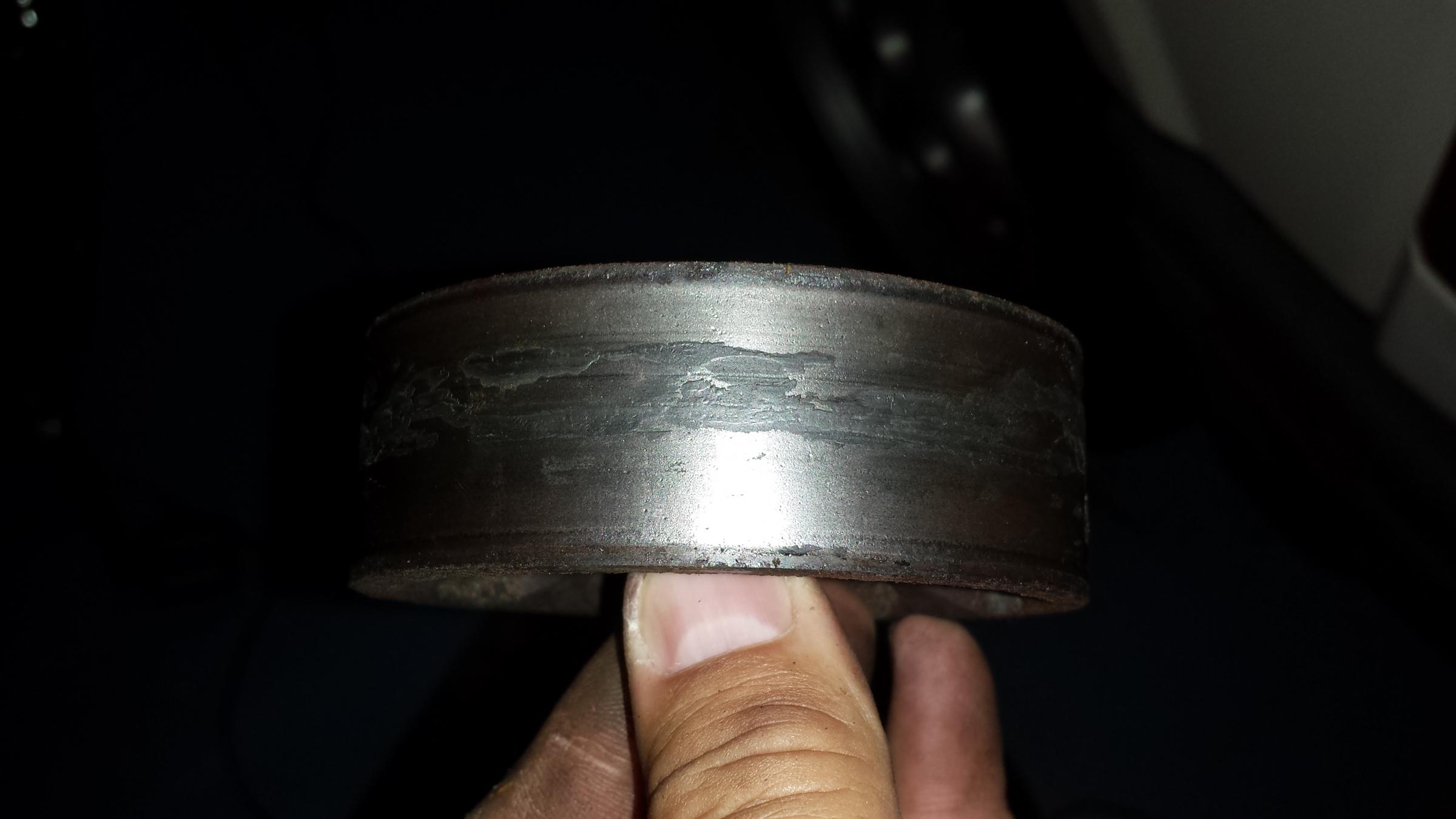

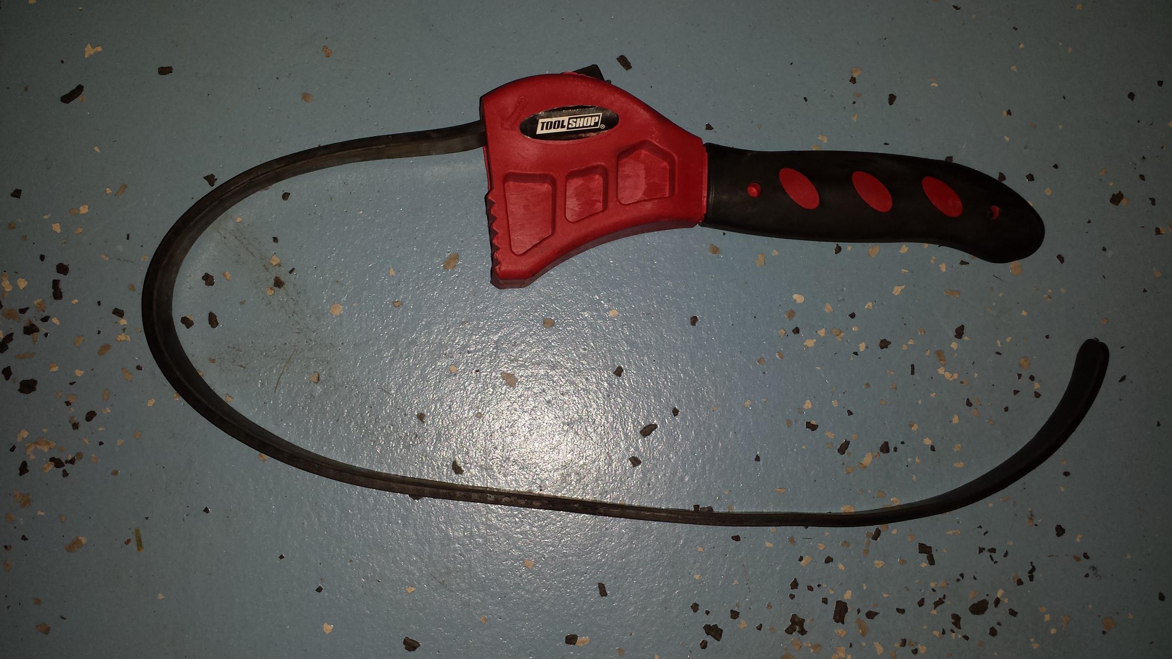

Red strap tool I had gotten a while ago from Menards made removing the fan clutch a super easy process. I actually had a 36mm wrench to go on the fan clutch nut but a large crescent wrench would have also done nicely. Rubber mallot to the wrench while holding the strap tool and no problem.
Tensioner pulley had some kind of gunk stuck to it - cleaned that all up when I had it off to replace the bearing. Getting the little circlip out (holding the bearing in) took a little work to do - was able to get it out with just a screwdriver. Pounded the old bearing out from the back using a large socket and rubber mallot. Pressed the new one back in by setting the old bearing on top of the new bearing and tapping it in with rubber mallot.
