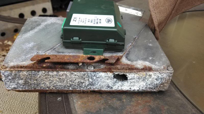

Also noticed the check engine light no longer illuminates when the ignition is switched on. Found this official TSB that seems to match my symptoms... GEMS no-start TSB
Old Nov 16, 2013 | 03:50 PM
philndz's Avatar
Joined: Oct 2013
Posts: 11
Yep...pulled out the ECU and alarm unit. As you can see the bottom of the ECU case had turned to dust. Connected up a good used ECU/Alarm unit pair, turned the key and....nothing.
Wait...perhaps the pair need to be 'unlocked'.
Get out, and lock, then unlock the doors. Turn the key....fires right up.
