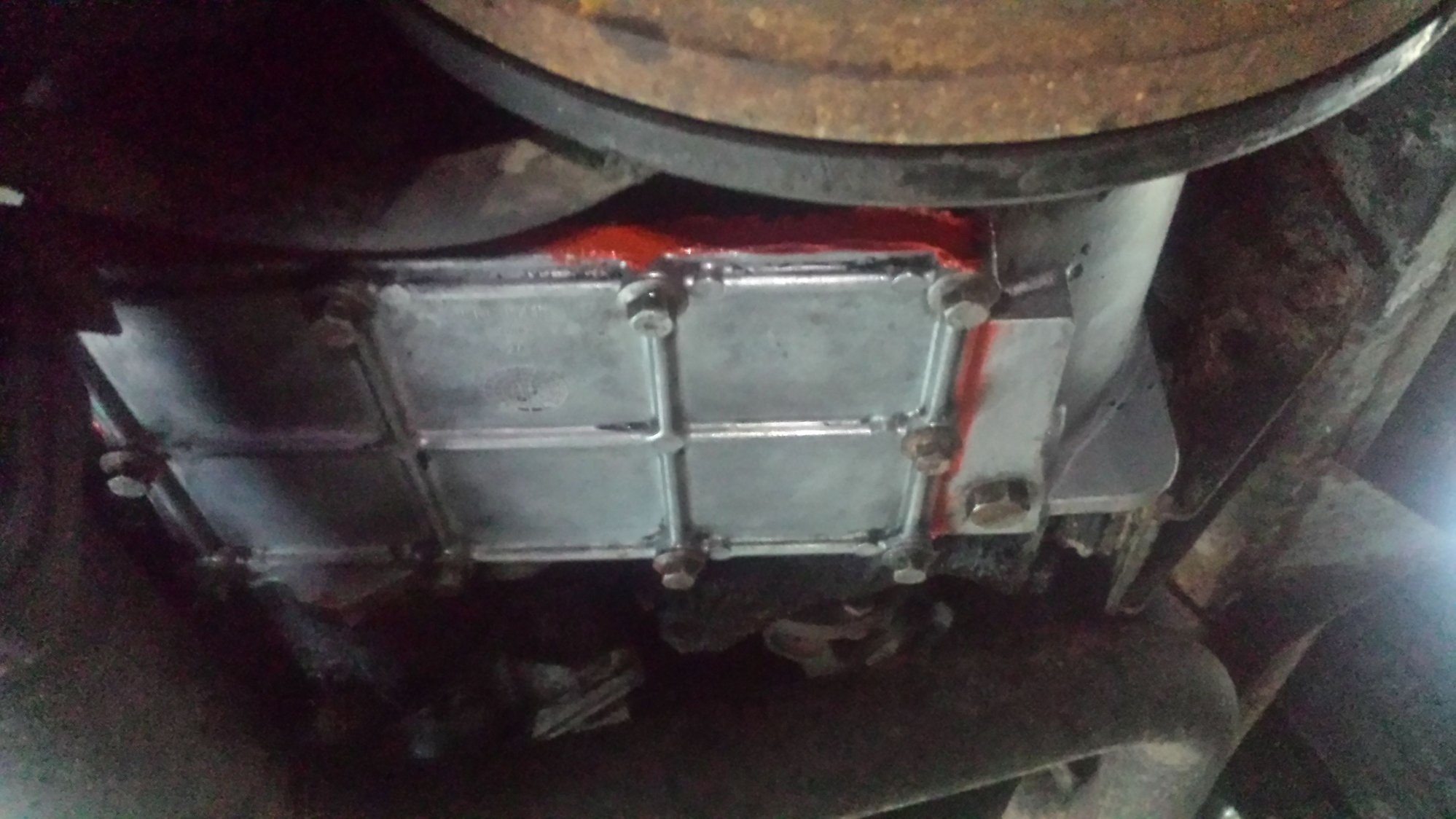

Drained transfer case oil today. It was a dark stinky mass so who knows when it was last changed... pulled the transfer case inspection cover and resealed with RTV. Will refill tomorrow once the gasket has set in. Gears in the Tcase looked alright...
