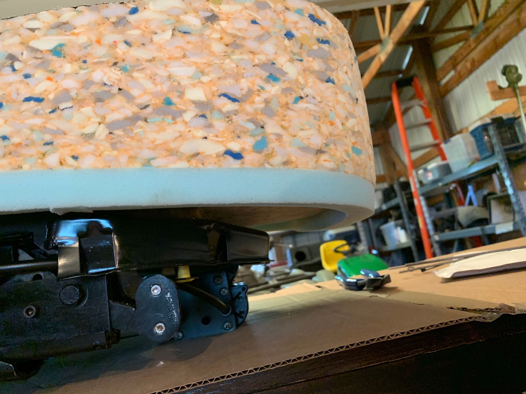

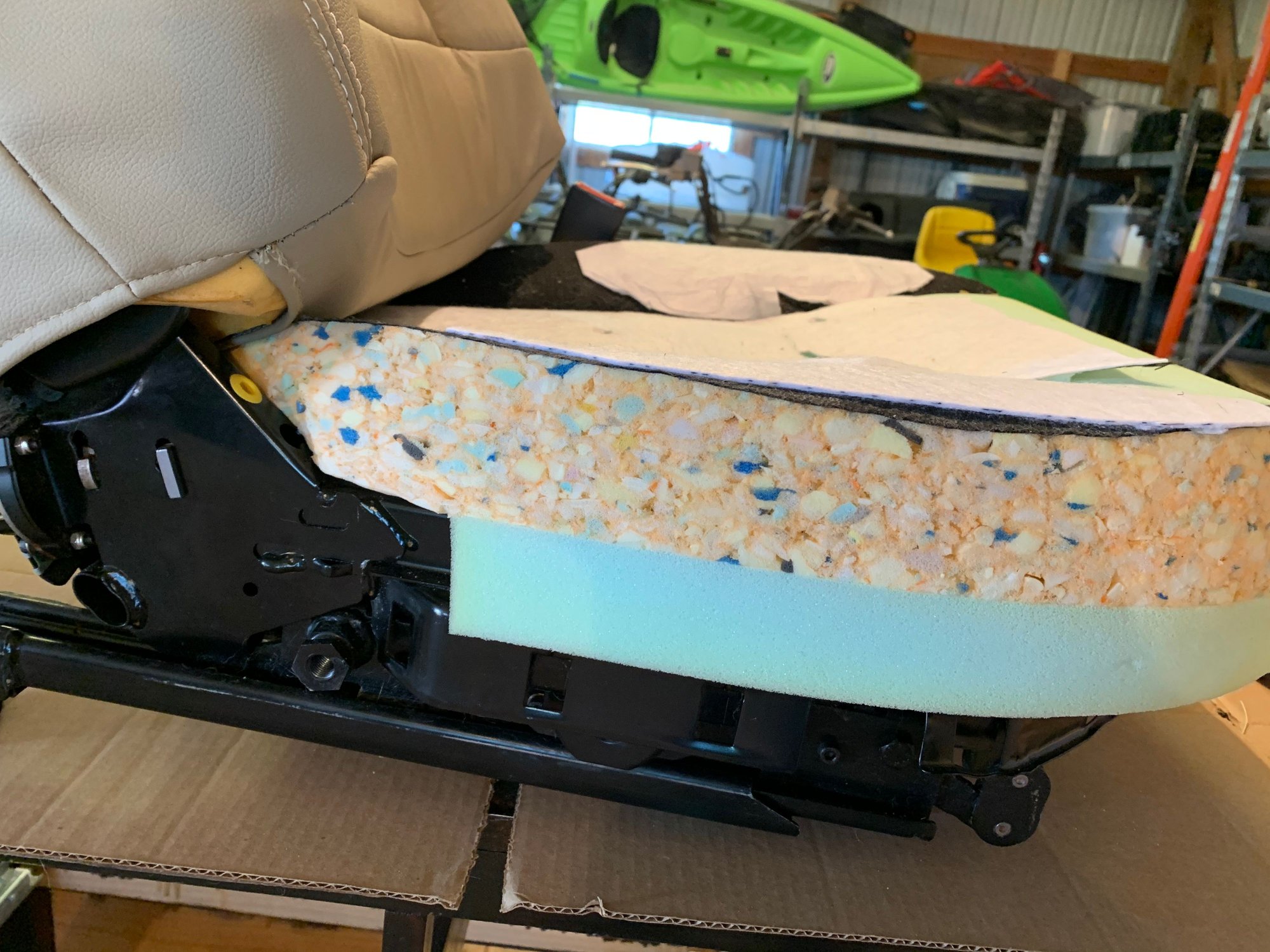

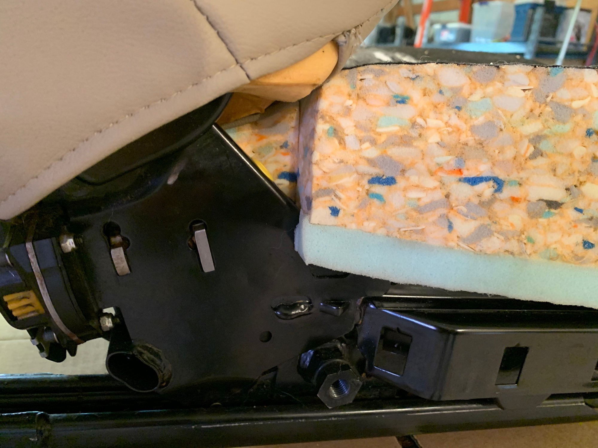

Anyway to trim the excess so it will fit?
I definitely could do that, which wouldn’t be a huge issue, but the worry is that I got the wrong item...
Below are images of my seat with seat foam from exmoor advertised for 1999 Discovery’s
Back of the seat foam. Seat frame seems to be too tight to accommodate the seat foam

so, here’s the confusion. Yes I did originally purchase that base foam you just sent. Problem is, that base foam works only for D1’s up to the year 1996.
When I bought the seat foam you sent above it was too wide and way too long. The seat foam that I have for the D2 now is a much better fit, but as the pictures show above it seems to be off still... unless I trim it of course.

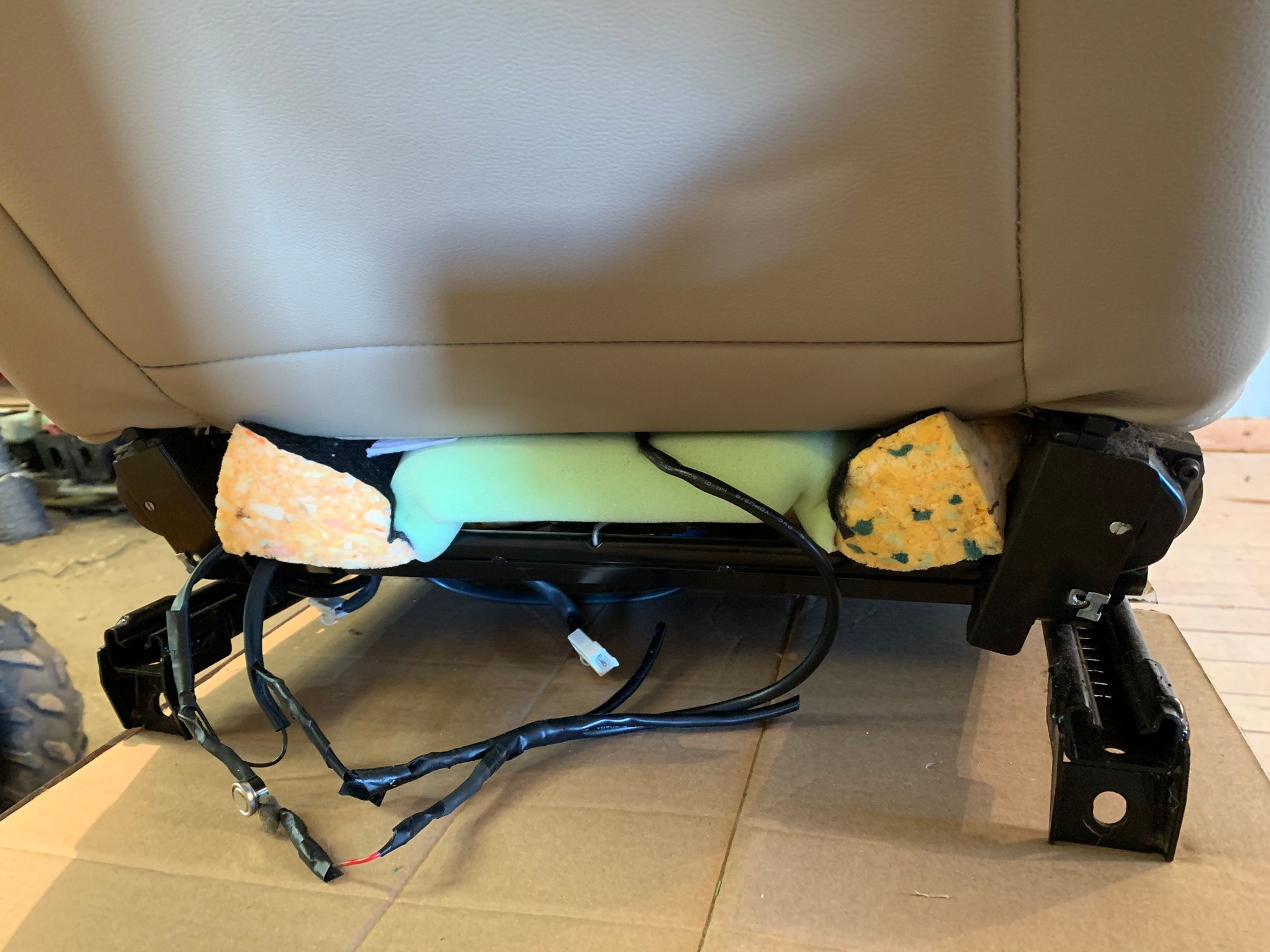

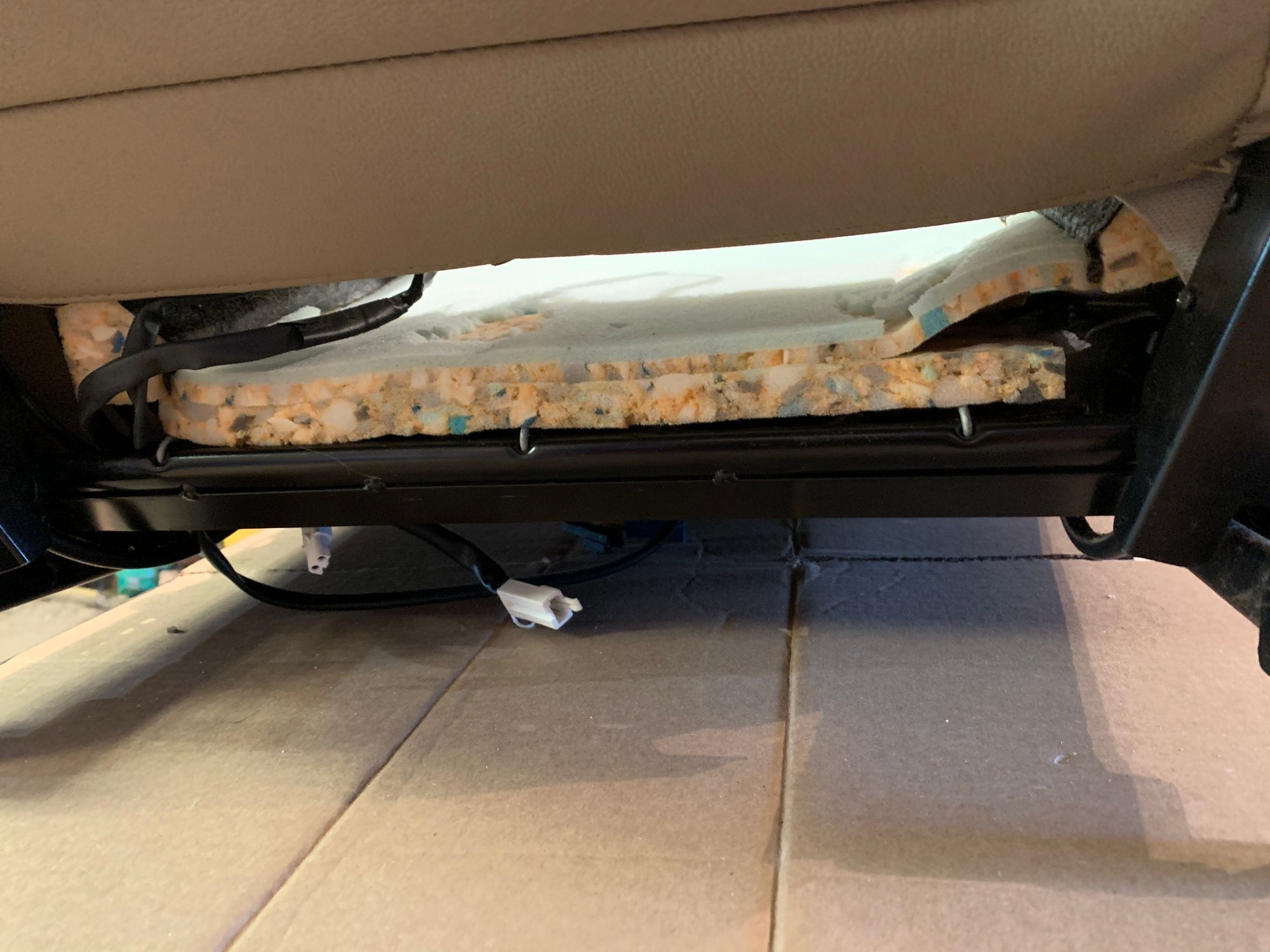

Yeah, definitely throwing me for a loop.
So I happen to still have the seat foam for the majority of D1s that you sent the link for:
Back looks like it fits much better
Front hangs wayyy over
