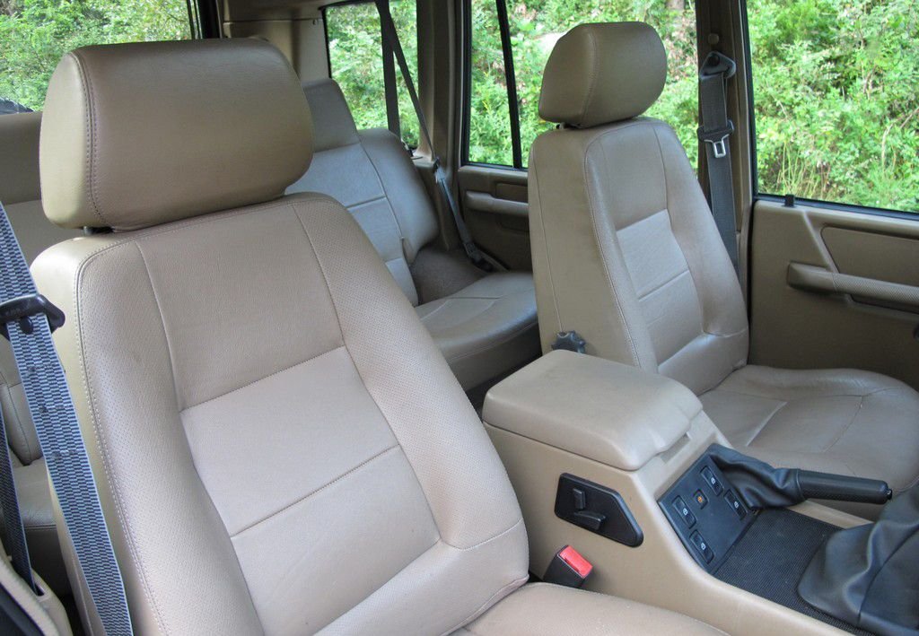

The DI 94-95 seats are different from the 96-99. I have seen other Disco's with leather replacement but not with the actual seat foam. I'm sure it has been done but I don't have any first hand knowledge. How are you getting the new foam into the old seat?
94-95
96-98,99

all the seat bottoms are the same for D1 89' to 99' - seat backs not - as shown above (with correction 97-99) not 96
