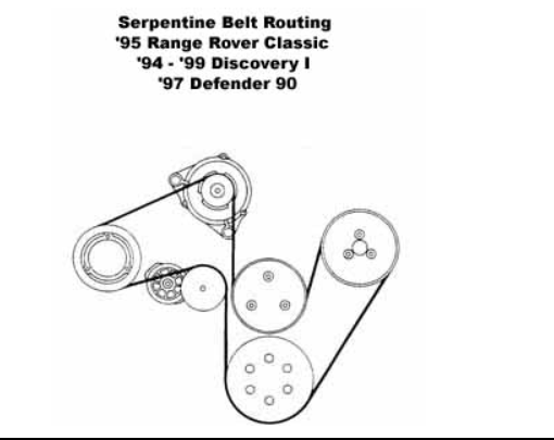

Either that or belts misrouted...... not uncommon for the DIY crowd.

The impeller works better in the opposite direction.

Sharpie on the support
