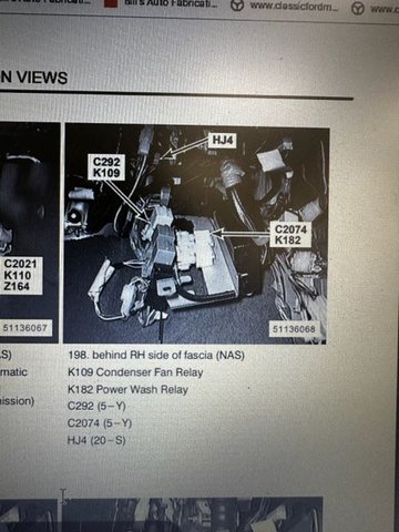

I have a relay that firing like crazy when the key is on C292 in the attached picture which makes no sense its for a condenser fan I also found what appears to be a broken off wire and a spot that has wire left in the connector on the security module.
The broken off wire is a copper core black and white coated wire with a non copper shielding wire I see no evidence of copper wire in the connector on the module.
