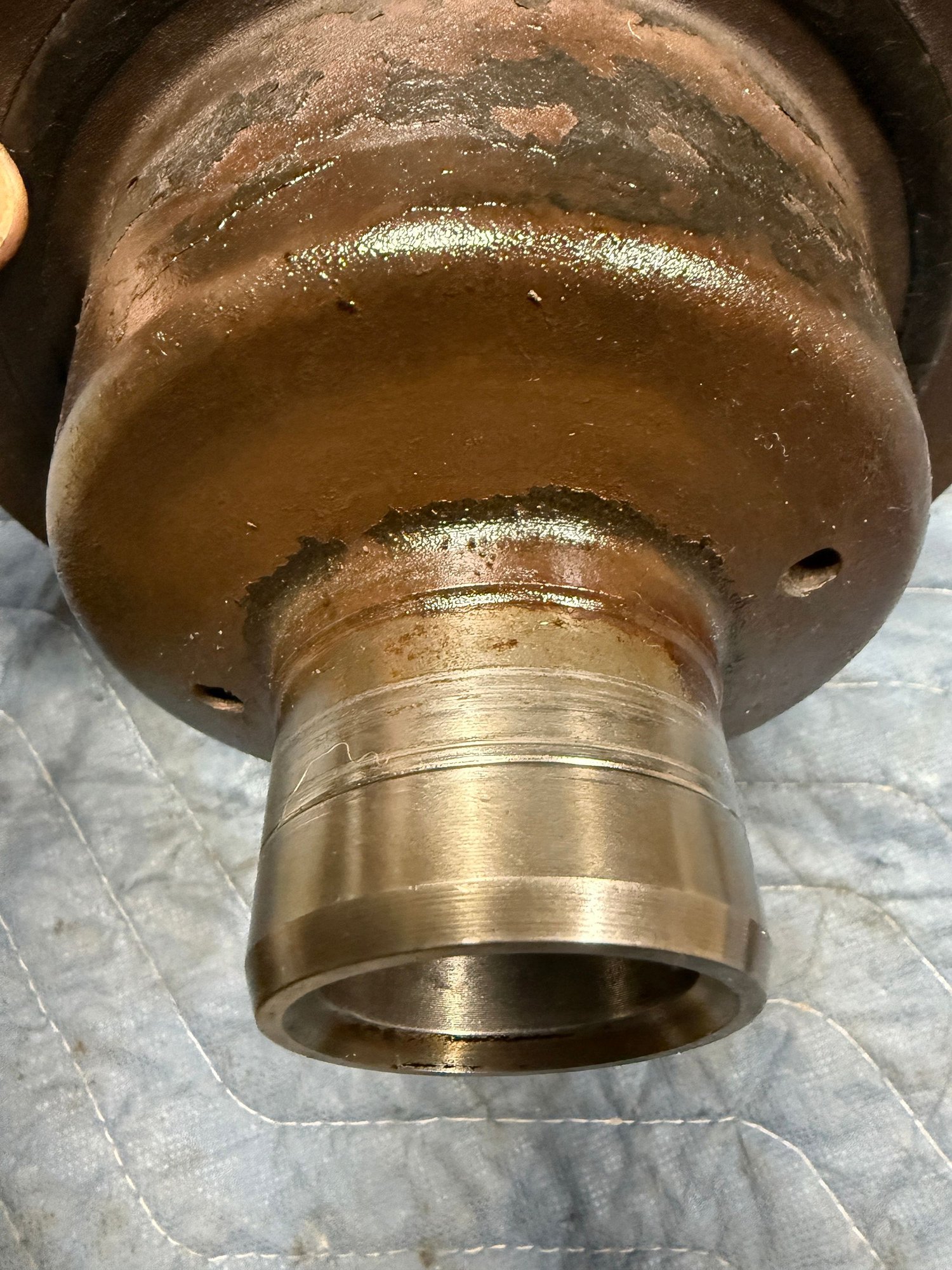

Well, i think I know why my front crankshaft front oil seal is leaking...what you guys think, time for crankshaft pulley sleeve? Is it SKF 99192?

yes speedy seal

I'm not familiar with that seal. But an offset seal or even just no hammering one in all the way helps it ride in the different spot.

Mark, that's a basically sleeve on ring you are pressing on the shaft, so you can have smooth shaft surface again.

Yours is definitely worn thats for sure. Let us know how it goes...

I think the term is "Speedy Sleeve", not "Speedy Seal". I think they're readily available at most auto parts stores. Bring your part in to get the correct size.

yes yes speedy sleeve - my local LR EXPERTS use them

The position of the sleeve is set by tapping it onto the shaft with a hammer and spacer. Good to make marks so the groove is pretty well centered with the sleeve. If the sleeve goes too far, you might need to try again with a new sleeve, because they stretch.
