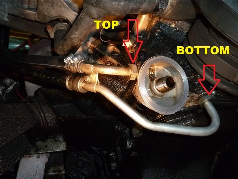

Can anyone that has a Disco 1 tell me which engine oil cooler line goes to what port on the radiator. I removed mine and upon installing the new oem lines I forgot which one goes where. Ex. does the line that connects under the oil filter connect to the top side of the radiator or the bottom.

The line under to the drivers side of the oil filter goes to the BOTTOM of the rad/oil cooler.

That clears so much confusion for me thanks, I had them flip floped, no wonder why one was kinking up. BTW that picture is great very clear, what you guys do on this forum is amazing. Forget land rover above and beyond, it should be land rover forums above and beyond. 😃😎
