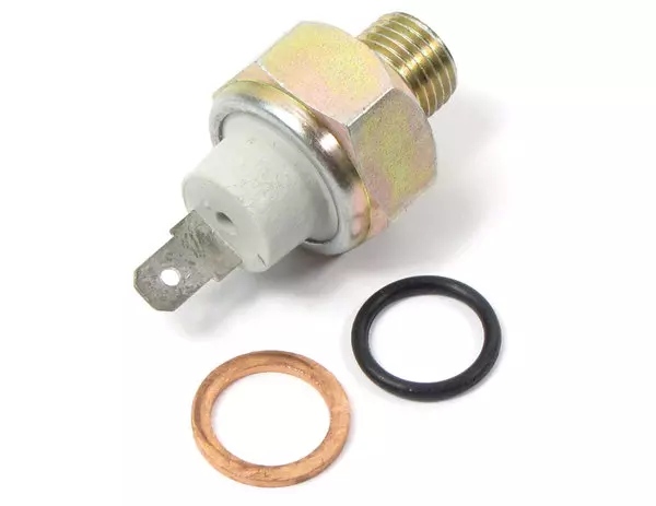

I've been having a recurring issue where the oil light flickers or goes solid at idle after highway speeds. This first happened at the Eisenhower Tunnel on the way up to the mountains for a ski day back in March, which was a pucker inducing moment. The oil level checked out fine (full) and there was no ticking indicating low oil pressure. This happened 3-4 more times sporadically over the next few months. I inspected the oil pressure switch and it wasn't leaking or weeping that I could tell. I decided to replace it about 3 weeks ago and I've had no oil light issues since then, even during this 100 degree heatwave we're experiencing this week. Luckily it's only a 5 minute job to replace the switch.
I previously replaced the switch about 3 years ago with a switch from AB that had a weep hole. The new switch is a different style with no weep hole which Rimmer Bros claims is a LR genuine part.
FYI - Per AB, if your Disco has a sepentine belt, only use the o-ring for installation.
Replacement switch style
Old switch style
