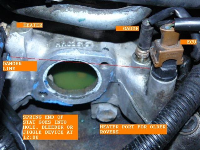

See sensor on left. Remove single wire that goes to gauge. With wire brush or scrubby pad clean sensor top and center stud. Gunk there makes a second path to ground, and makes readings higher. Skinned wire will do same. Ultra Gauge or a scanner read the OBDII engine coolant temp sensor, which is the one on right with square top (two wires).
Also, if the thermostat was installed backwards, not good. Spring goes inside block. Small 1/8 inch hole or jiggle device goes at 12:00 to prevent steam pocket buildup. Spring for a gasket and check. Better yet, a new $10 180F stat. Don't buy the fail safe models. Stats can be heated in a pot of water to confirm temps.
