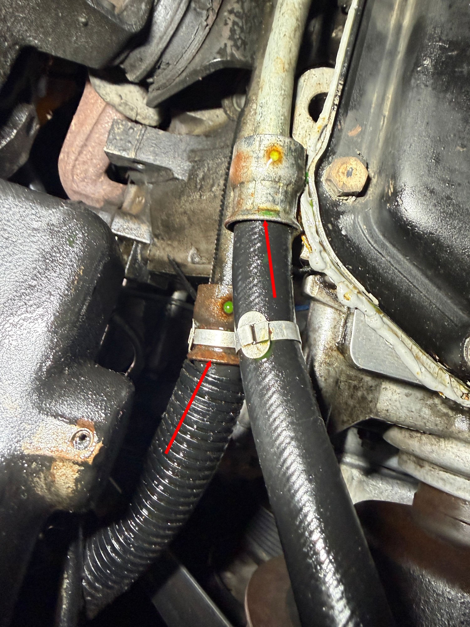

I see what you saying, but switch area is dry like a bone. I'm getting leaks from both hoses here (red arrows). I already have "coolant" hose, just can't find the other one. BTW, for the "coolant" hose, do you know if can i change it without draining whole coolant? That would save me some work...
I also have a problem on this hose, that one is coming from the top of the radiator on the driver side and then goes into the transmission cooler (I think this is ESR3695).

If push comes to shove, the ATF cooler hoses can be renewed at a hydraulic repair shop. I noticed the kit of three hoses from Roverparts is out of stock. The drips in the photo look like coolant, not ATF, so could be water pump or timing cover coolant leaks.... Some forum members, like me, run the trucks unpressurized to help prevent coolant leaks. Ensure coolant concentration, then simply loosen the reservoir cap to unpressurize the cooling system.

John, so both those hoses are moving oil only, right? I had some brain freeze and somehow i thought that coolant gets in one of these...i guess its because of that coolant stain.
Also, you are correct, this is 100% coolant in my picture. I don't have any leaks from the timing cover or the water pump - all is bone dry now. However, I did have large coolant spill when filling out the radiator after all the work done on the top of the engine...I left the open coolant jug on the top of the engine when looking for the different funnel, and my garage cat took that challenge to his heart, by knocking it out... lol, that was fun to clean it... i bet that some of that coolant went on those hoses and etc...

Yes, those hoses move ATF oil, all three you pictured, from transmission to radiator to front oil cooler, then back to transmission. I think that's the sequence, or maybe mixed up between radiator and oil cooler.

ok, i run i just run it today morning, i have another small leak in the radiator, then coolant drips at the hoses up front, and i guess when i'm driving, wind is just pushing / splashing coolant down. It's very small leak, but it's visible. I will try to fix original radiator in my local shop, we will see if they will take the job...fight continues! Ha!
