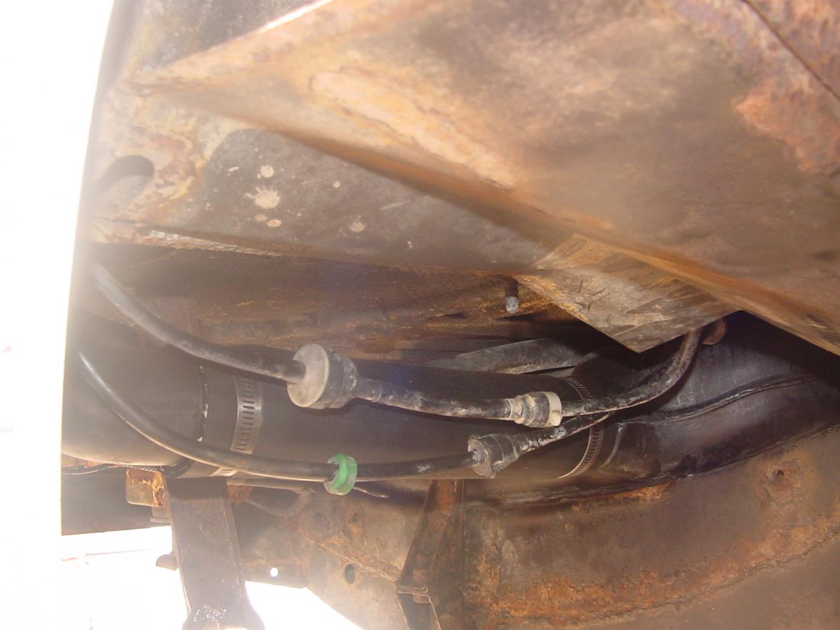

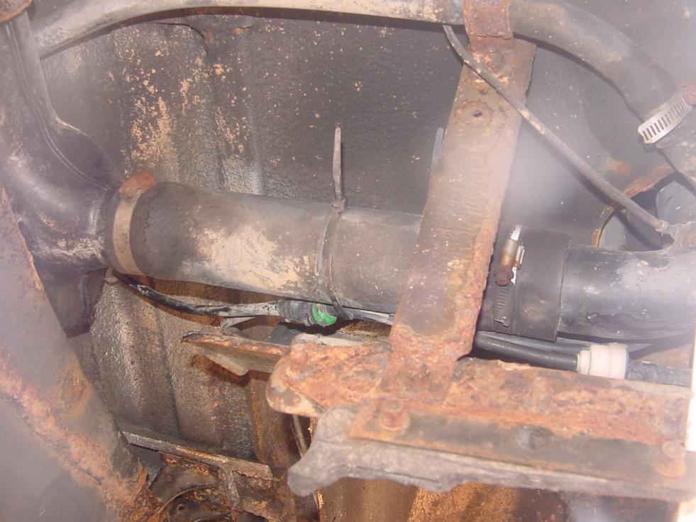

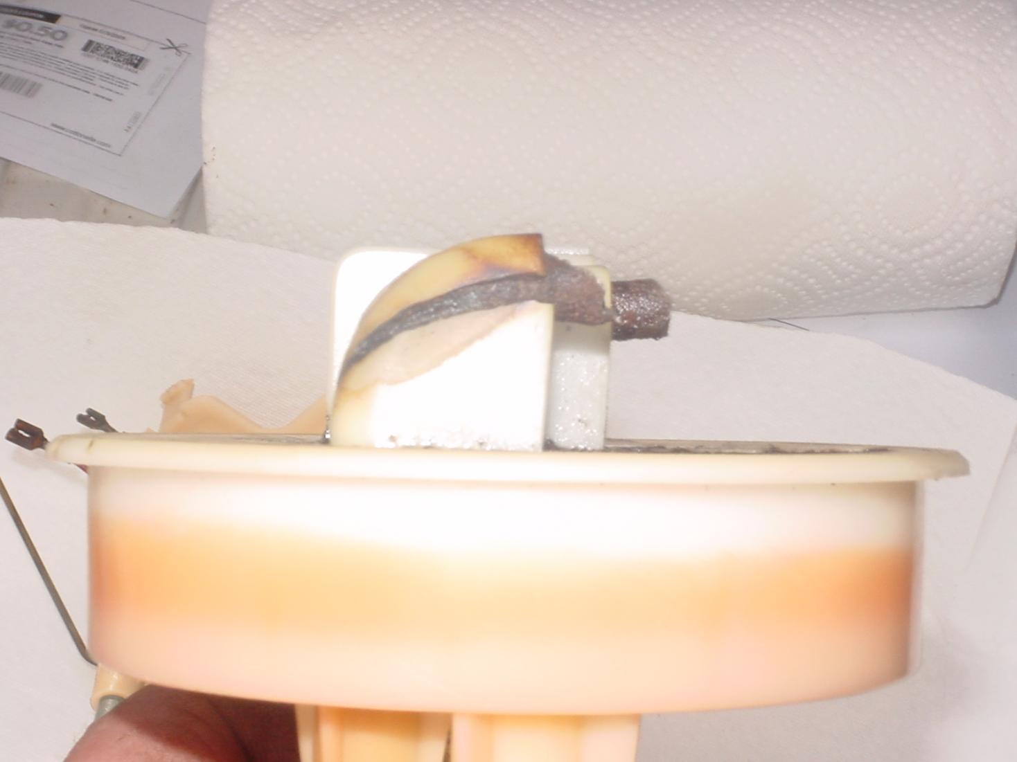

Before you go to the trouble of dropping the tank, make sure it is not the steel fuel feed/return lines that are leaking. If they are original, I would bet they have corroded to the point of imminent failure.
The fuel line from the fillere neck is in the following pics. the third one is a line I am unsure of it's function, but that is the condition on mine. I will have to search some more pics to find the ones I took of the actual feed and return lines, also the top of the fuel pump assembly could be leaking like mine was.
Attached Thumbnails Plug Fouling 96 D1. All plugs.-dsc01629.jpg   Plug Fouling 96 D1. All plugs.-dsc01661.jpg   Plug Fouling 96 D1. All plugs.-dsc01684.jpg

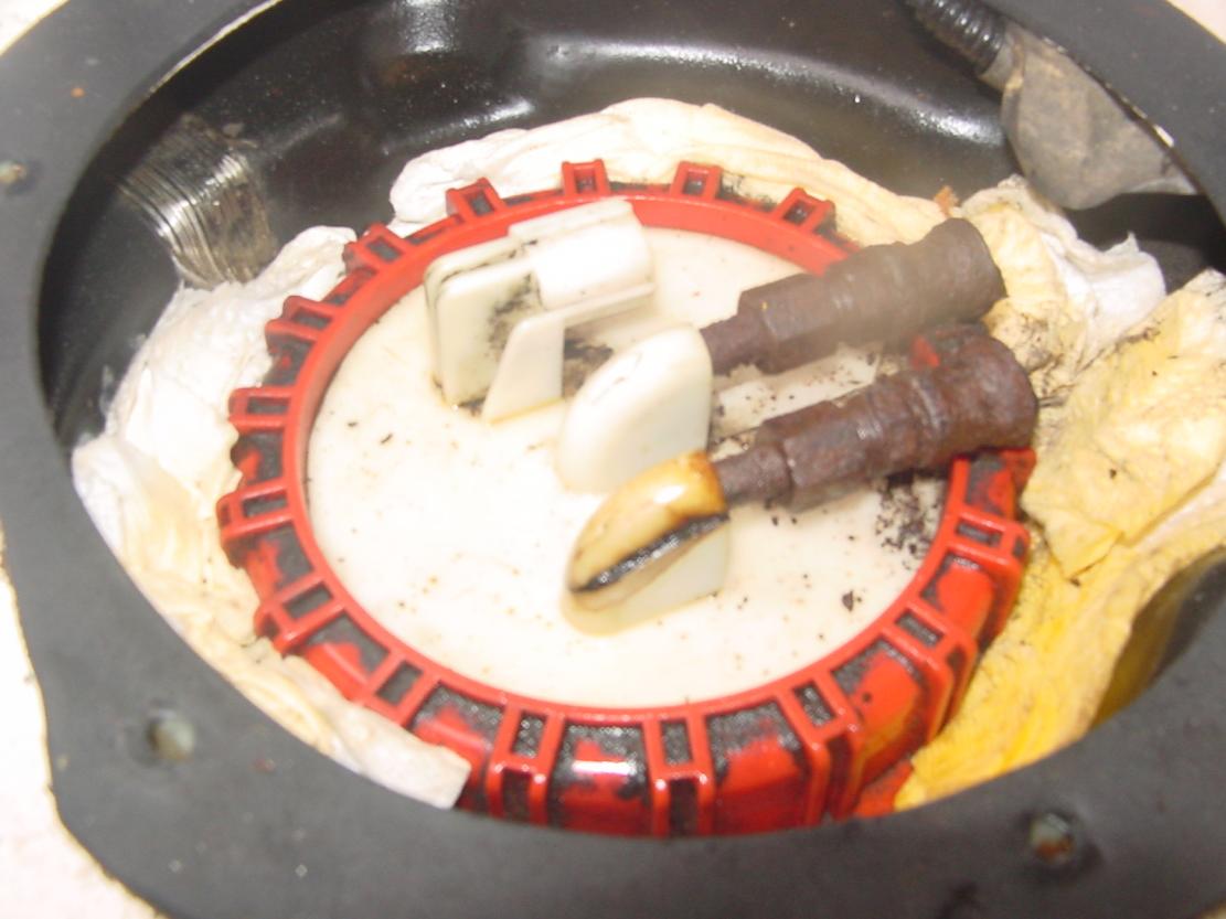

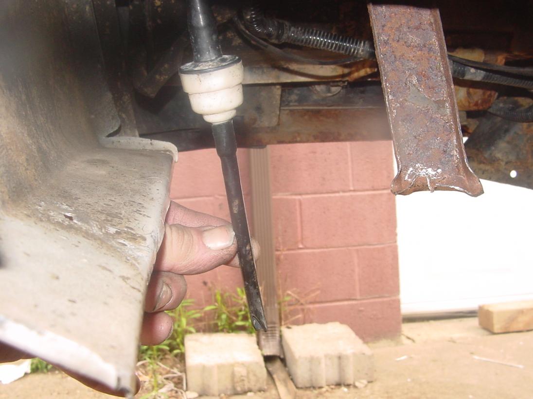

Here's some more pics of where mine was loosing pressure/leaking.
Attached Thumbnails Plug Fouling 96 D1. All plugs.-dsc01610.jpg   Plug Fouling 96 D1. All plugs.-disco-april-2-2010-076.jpg
