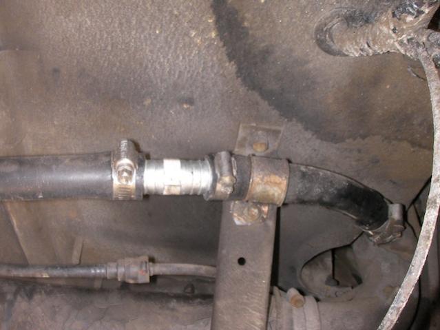

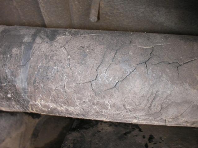

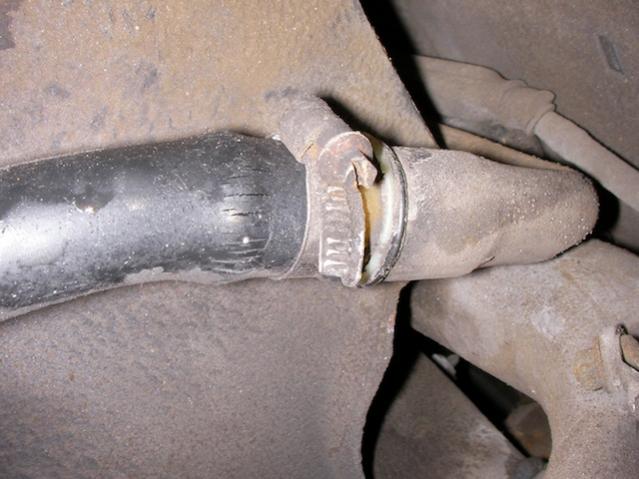

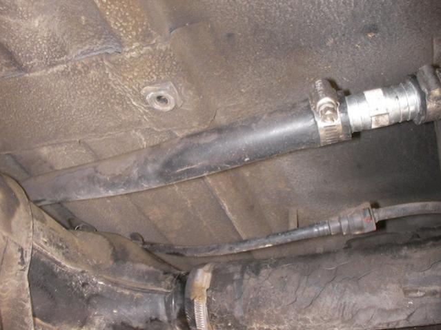

On the fuel line....
Here are pictures of the issue...
Here is one end of the line, Badly cracked, but not leaking.
The leak is coming from above the tank, when full, then pouring down the side over the big line.
The big line looks to be in nefarious shape itself...
As you can see, I have already spliced one break in the hose. (was done to get it to the shop.) This was before the second bigger leak started.

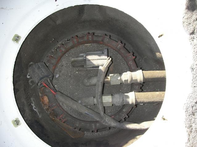

Looking at the hoses accessible from the access panel in the rear, this leaking hose does not seem to be one of them. I'm not really sure where the leaking hose even terminates right now on the tank, but according to the rover manual you have to drop the tank to get to it. (unless someone can tell me another trick) Also, which hose is it exactly? looking at the parts, I can not tell what I would even order to replace them.
Note, this picture is actually turned 90 degrees. The hoses actually exit toward the front of the truck, in this picture the area where that hose should be would be at the very bottom.
Also in this picture, you see a plug, that's not hooked to anything... and there seems to be nothing around for it to hook too... I'm guessing some option I don't have?

Man,
Take a look here: https://landroverforums.com/forum/members/danny-lee-97-disco-20663-albums-danny-lee-s-disco-272/
Clean the top of your fuel pump assembly real good, then start your engine and observe it under full pressure. If the top of yours is cracked like mine was, you'll see it leak under pressure after a good cleanup.
As far as your hoses, the big one from the filler neck is defitely shot. I got mine from Rovers North. Perfect fit. Mine does not have the same smaller hose like you have, but in the next to last picture you posted, why is one end darker than the other if it ain't been leaking? Replace all that stuff to reduce your existing problems.
