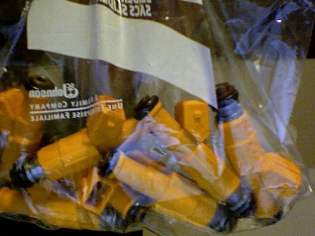

Here's my plan of attack.
Going to toss in those injectors. Then limp the truck over to my guy that I have change oil. (It gives me access to a lift) Going to add a quart of kerosene to the oil, and let the truck idle for 5 min or so to warm it up then flush the engine with new oil and filter. Then drop the oil pan completely exchange it for another one I have for the truck. (My current pan's oil plug is crapped out) This will give me a chance to see the lower end and see what kind of mess I'm dealing with as far as gunk.
Then going to refill and maybe add some of that mystery oil and let it do it's thing.
Between the flush and the MMO treatment I would say I have done my best barring a tear down. It's a crap shoot but cheap and should tell me something.
If the truck starts running right, I'll then tear it down again and try and see why that valley pan seems to have not sealed correctly and redo it.

Mailman came....

Looks like fun. Let us know how the install goes.

I hate to poop on your cornflakes, but I will bet it will still run the same. You have a sensor somewhere goofing things up.
I will get the values of my sensors when you want to do yours for reference..
