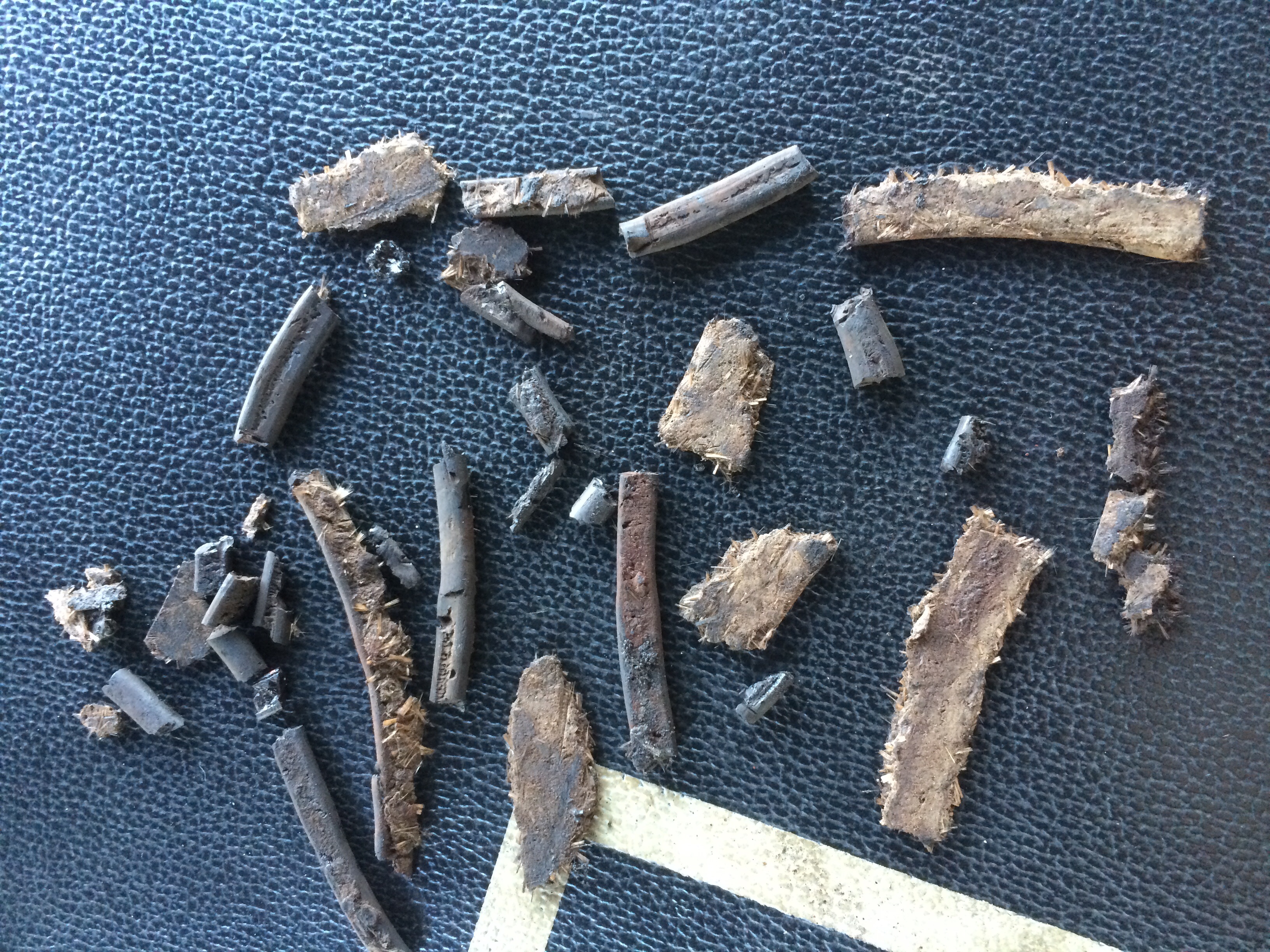

Found this in the bell housing. Bits of friction material and some rubber pieces; there's more still inside. I suspect the clutch has self destructed. Thoughts?
