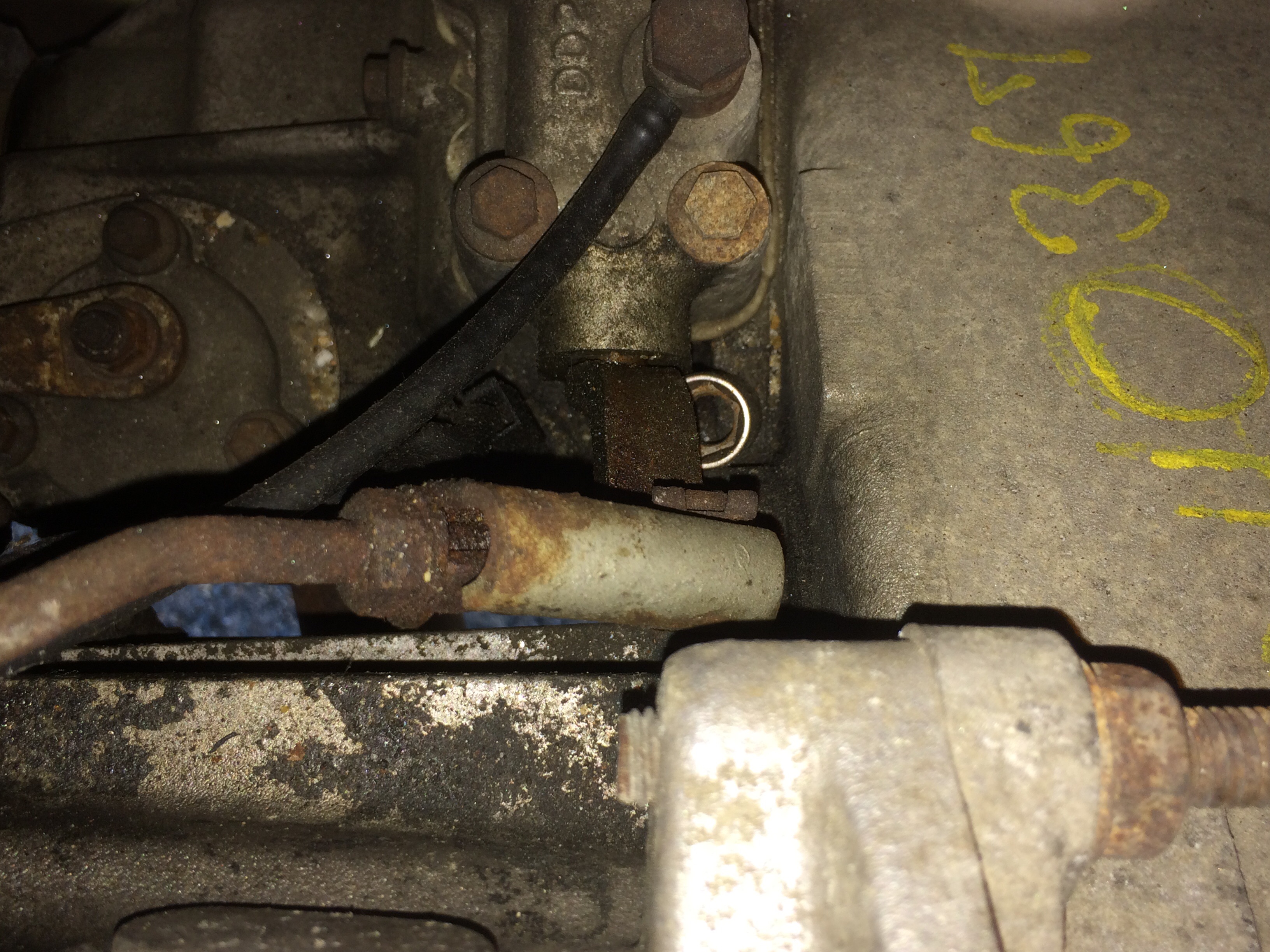

Forgot to mention, earlier in the day I removed the center console and rubber boot around the shifters to do some vacuuming and become familiar with the work area. Looking down, wedged in the hi-lo range shift linkage I found this little guy (the little shiny circle in the center of the picture)

does it shift with the socket removed
The socket was only in the vicinity of the hi/lo/diff lock shifter linkage; and actually was wedged out of the way so it wasn't really having any effect on that. But, to be honest I didn't even try it after removing the socket. Once I saw the huge pile of clutch material inside the bell housing I figured it had to come out anyway.
