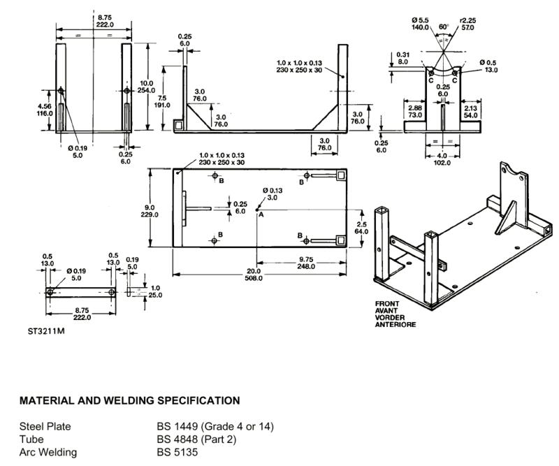

I highly recommend the R380 adapter and a transmission jack.
When refitting be careful that neither of the O2 sensor connectors have dropped down inside the bell housing.
Thank You AC, a couple of questions:
Is this adapter used in conjunction with the jack during the removal process; or just as a stand afterwards?
Does it take into account that the transfer case is still attached?
What do you think about making this, or something like it out of wood?
Although I have a welder, I don't have a plasma cutter so materials and labor outside of welding could get expensive and it's not like I will be using it that often (hopefully).
