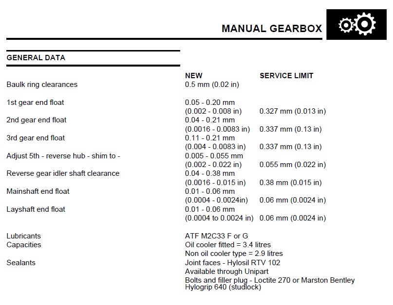

Hi Guys - going to do some maintenance on the 5 speed over the weekend, an cant seem to find a consistent answer on what oil to use in an r380 trans.
Whats the opinion??

The service manual can be found in the google drive link in my signature. Have at it.
See this page as well.
http://rovers.red90.ca/MTF.htm
