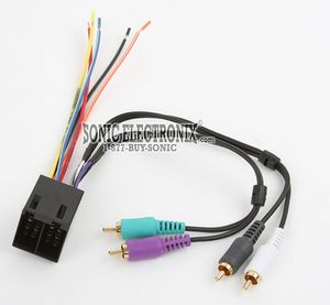

my truck (and most D1's to the best of my knowledge) have 2 factory amps, 1 is the sub amp in the sub assembly mounted to the cargo door, and the other is a 4 channel amp mounted either high in the passenger kick panel (that's where most are) or under the drivers seat (I think in some of the older models and I think some of the last models, but not sure) you have 3 choices of how to deal with this, option 1 is an amp integration harness metra part number 70-1786 (this will require your aftermarket radio to have front and rear low level/RCA outputs, total of 4). This is how 99.9% of shops will do a "standard install".

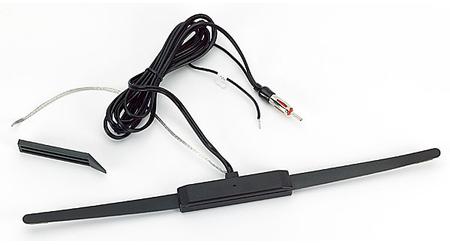

as for the antenna, if it is a mast style antenna you can use a universal replacement but if it is in the 2 back windows (little wires like defrost on the side windows of the cargo area) then you will need to get a windshield mount antenna like this one.
they do make a European antenna adapter that will work for most of us part number is metra 40-VW12

hope that helps. also forgot to mention, options 1 and 2 will require you too turn on the amp. this is done by connecting the blue/white wire on the back of your aftermarket radio to the remote wire on the factory ISO connectors (I think it is red/blue but I am not sure)
