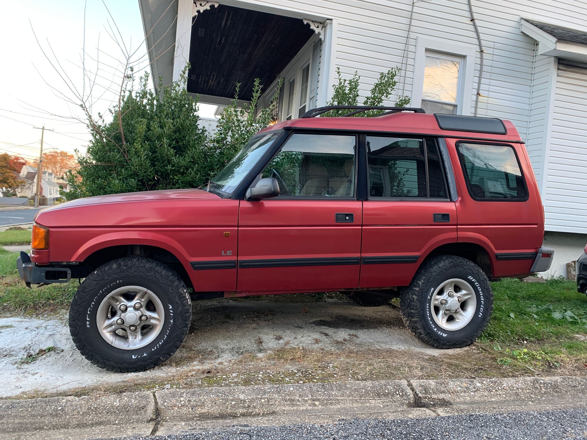

2) as I understand a 2" (total) suspension lift is the most cost effective lift for these vehicles. Above that you start needing new linkage, double Ujoint front driveshaft etc..... - just things to keep in mind. These vehicles have serious articulation in stock form - 1st pic is mine bone stock. - 2nd pic - mine currently - 31.5" tires / 2" lift. A 2" lift only requires caster correction radius arms & extended brake lines (and obviously springs and shocks). Personally, I think a 2" suspension lift and 1" body lift would prolly suit the 34's (if not super wide) with some additional 'Camel Cut' trimming. (Again, I only have a 2" - someone else may have better info regarding taller lifts/tires). When it was stock I had no problem keeping up with lifted toyotas on 33's - my truck was referred to as boring b/c 'it just lumbers over everything'

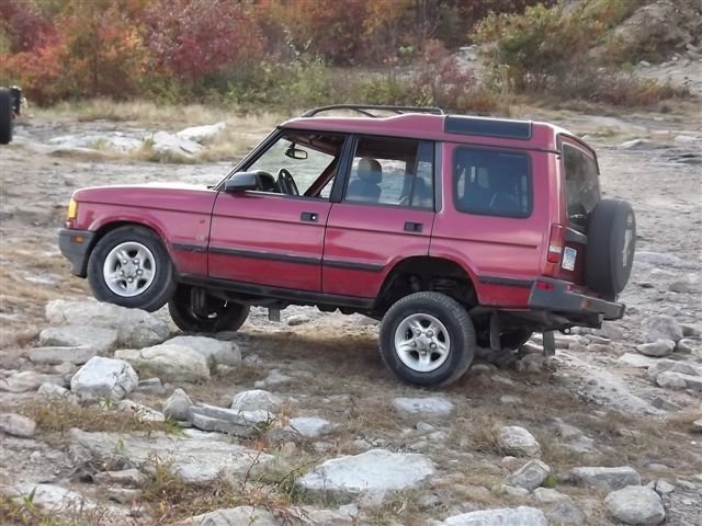

I wouldn’t mind a 2 inch lift, but TBH, 2 inches isn’t gonna cut it for the wheeling around me. We have rocks taller than the hood on that thing. I’m gonna need 4-6 inches minimum. I mean bare minimum 4 inches.
we shall see tho. We shall see. I took my other D2 with a 2 inch lift and my buddies with a 4 and his 4 was barely enough for some of the stuff around us here.

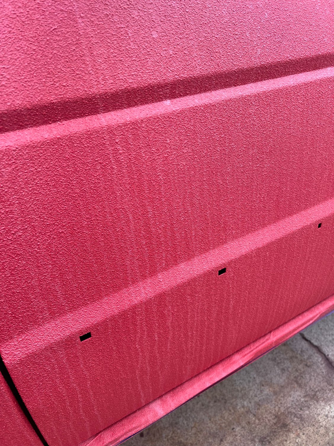

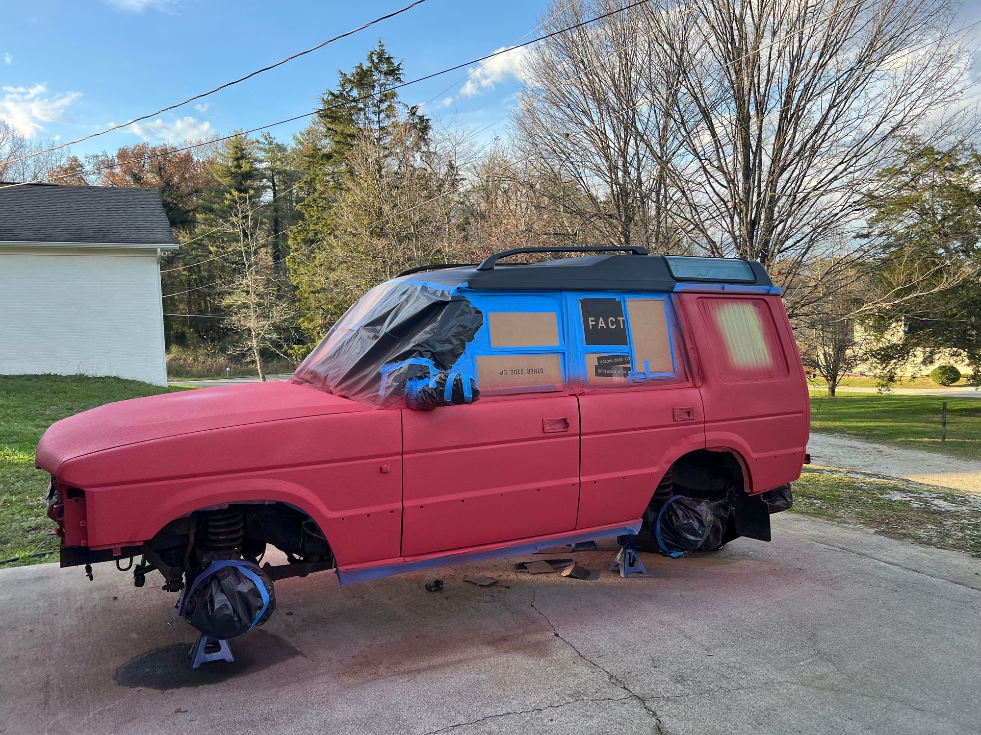

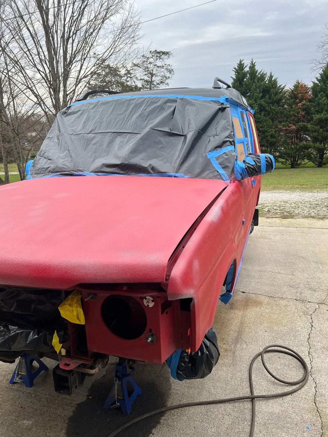

6 hours later and the final coats of “Portofino red” Bedliner has been sprayed. Pretty happy so far. Unfortunately it says it’s going to rain tonight now which was not expected. Luckily this stuff hardens quickly. But here is an update!

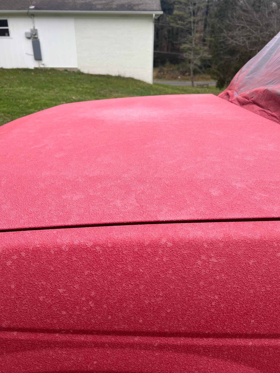

Update. The rain ruined it. Idk what to do. Want to cry but also idk if I can stop now. The rain turned it a pink color with white streaks

Originally Posted by WaltNYC
I suspect that with 6" of lift you will need new geometry on the A arms that holds the rear axle. The rear axle will move forward without it.
Walt any expertise with bed liners? Read my above!

oh man thats a bummer.
This happened to new Nissan titans. You could try looking on those forums.
