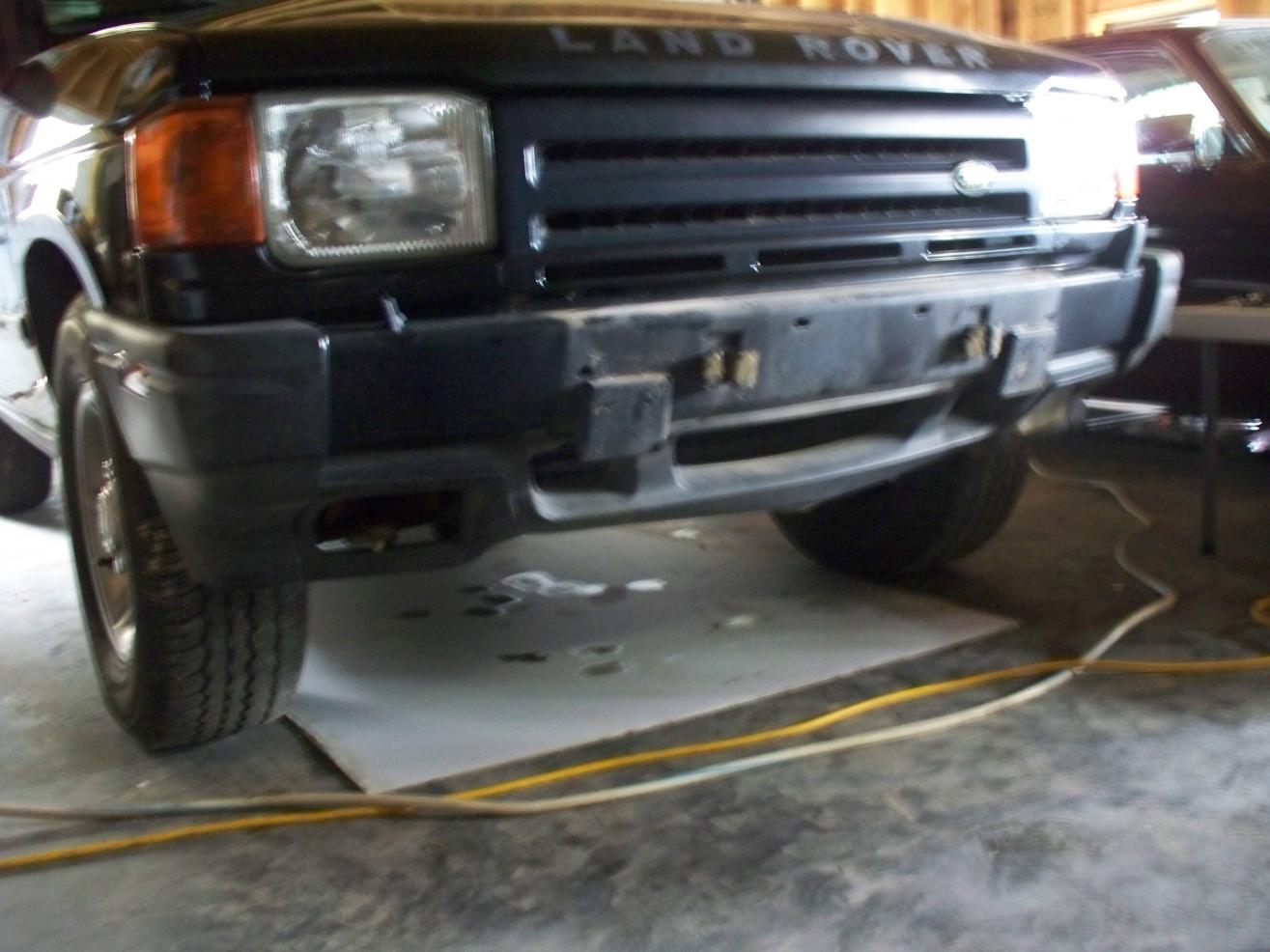

I removed the front license plate holder and discovered the mounting points underneath. Are these intended for mounting brush guards or something else?
Does anyone make a front 2" receiver hitch for D1s? I have a winch on a 2" receiver mount that would be handy to carry for winching from either end.

Brush guards are mounted to the frame horns, not to the bumper. There is one brush guard that is mounted to the bumper but I've only seen it on trucks in Europe and Australia. Not available here I don't think.

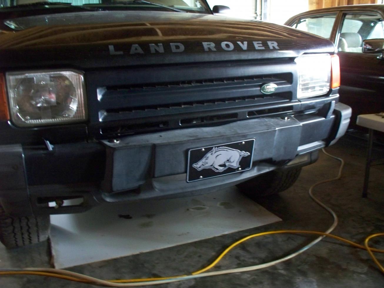

BTW, I bought a front plate I saw at Dollar General; not a huge sports fan, but thought the silver razorback sort of matched the black disco.
