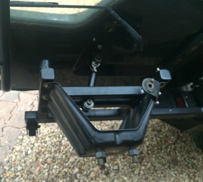

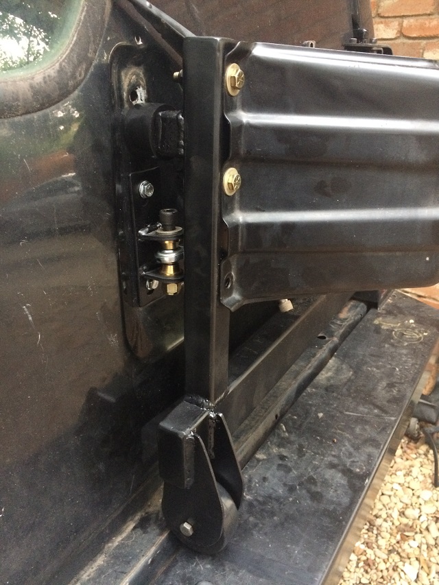

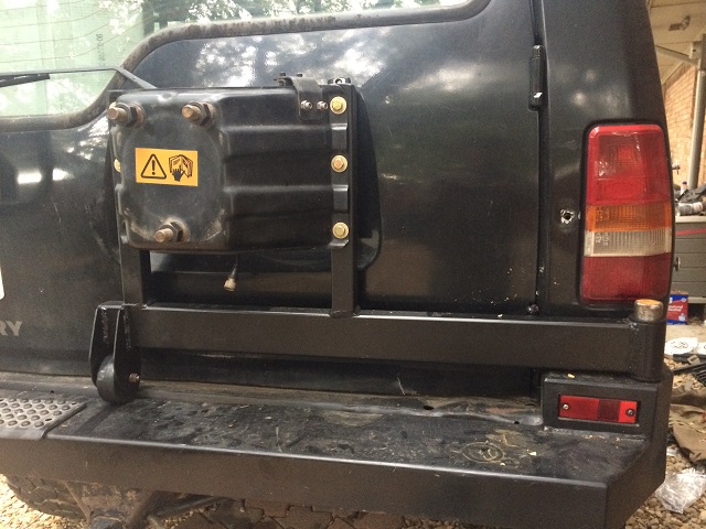

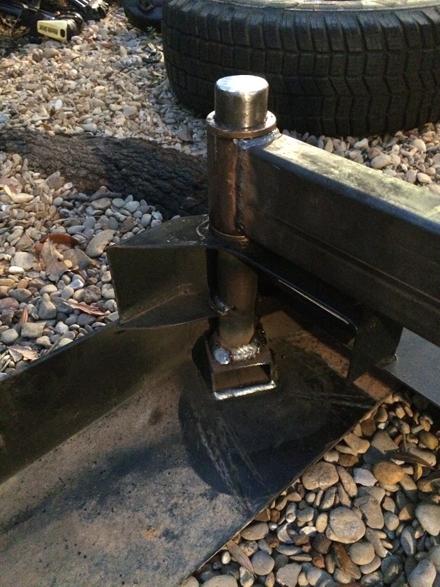

Originally Posted by robertf
That's brilliant, thanks very much.
I like the weight relieving castor to take the weight off the spindle, I was reading an article about trailer spindle failures from the weight of the spare hanging off them and them failing from fatigue over time.
I like the way you built the parallelogram, you've given me some great ideas to take on board, thanks.
