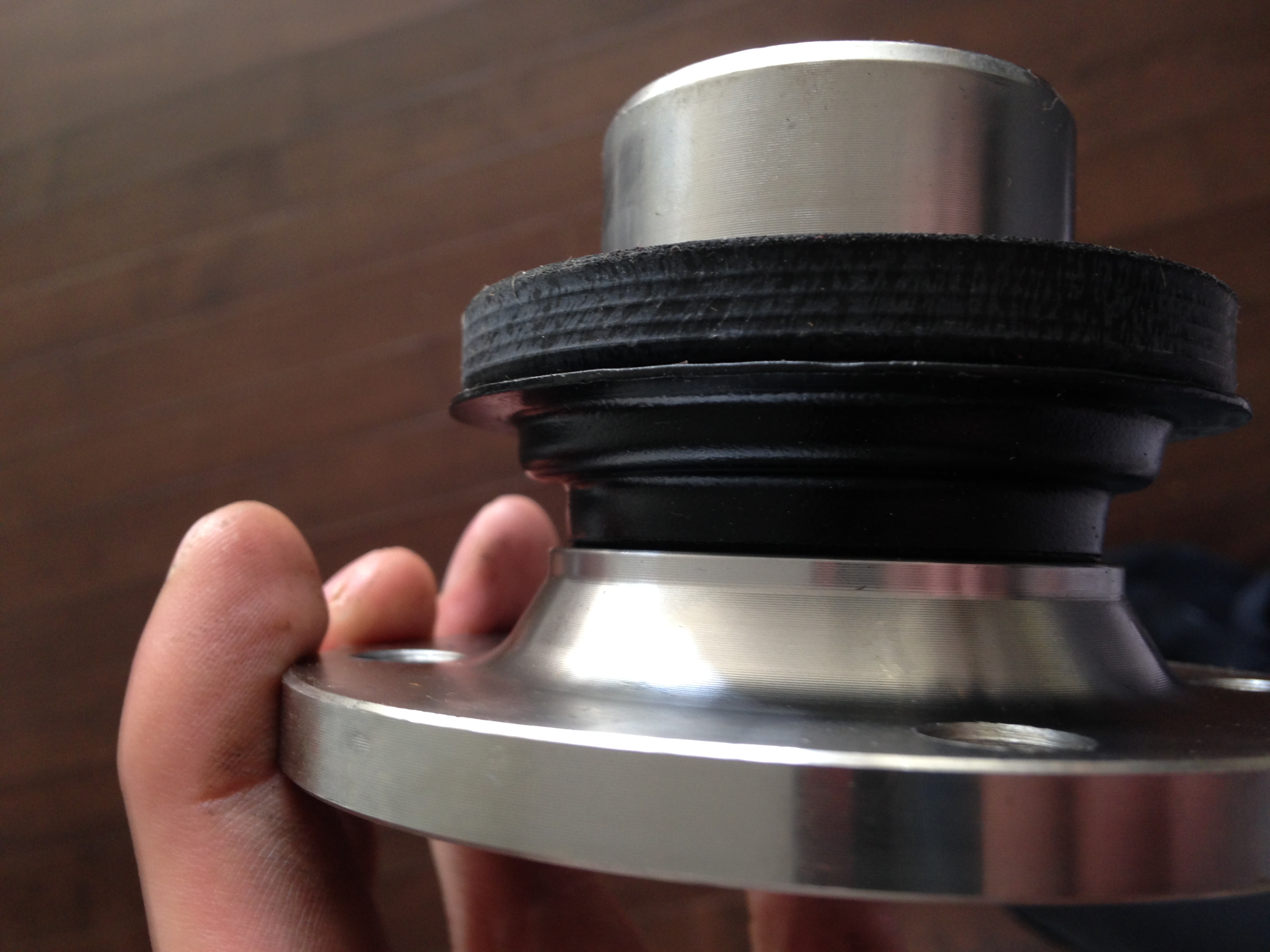

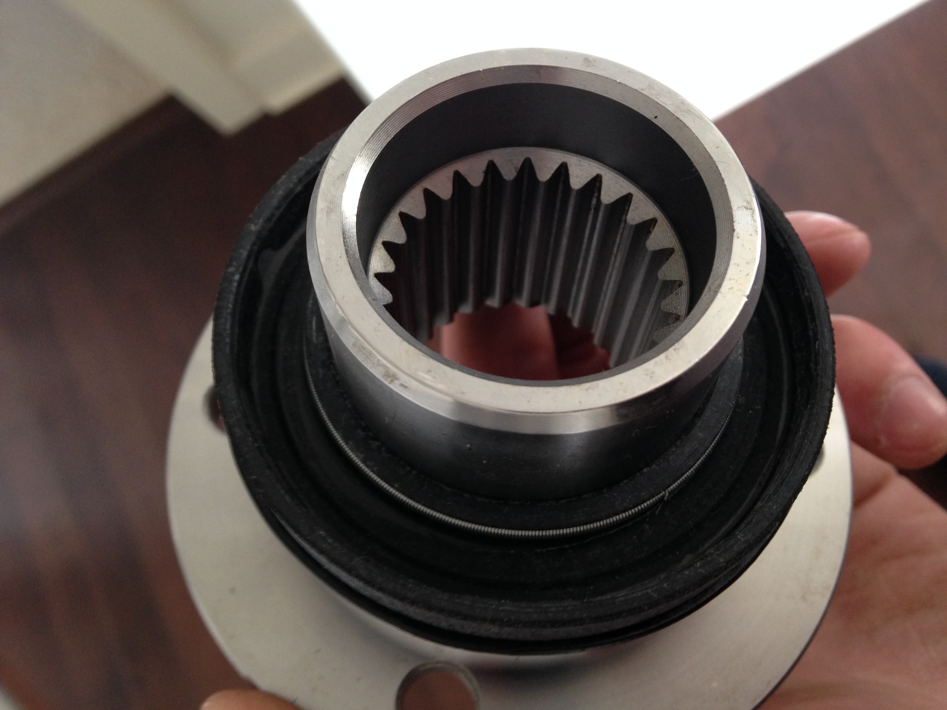

Thanks rangie, I sourced a used driveshaft with good joints and a Spanking new flange. Is the spacer a must? I'm only putting on about 2 inches? I'll take a picture of the rearshaft at some point tomorrow.

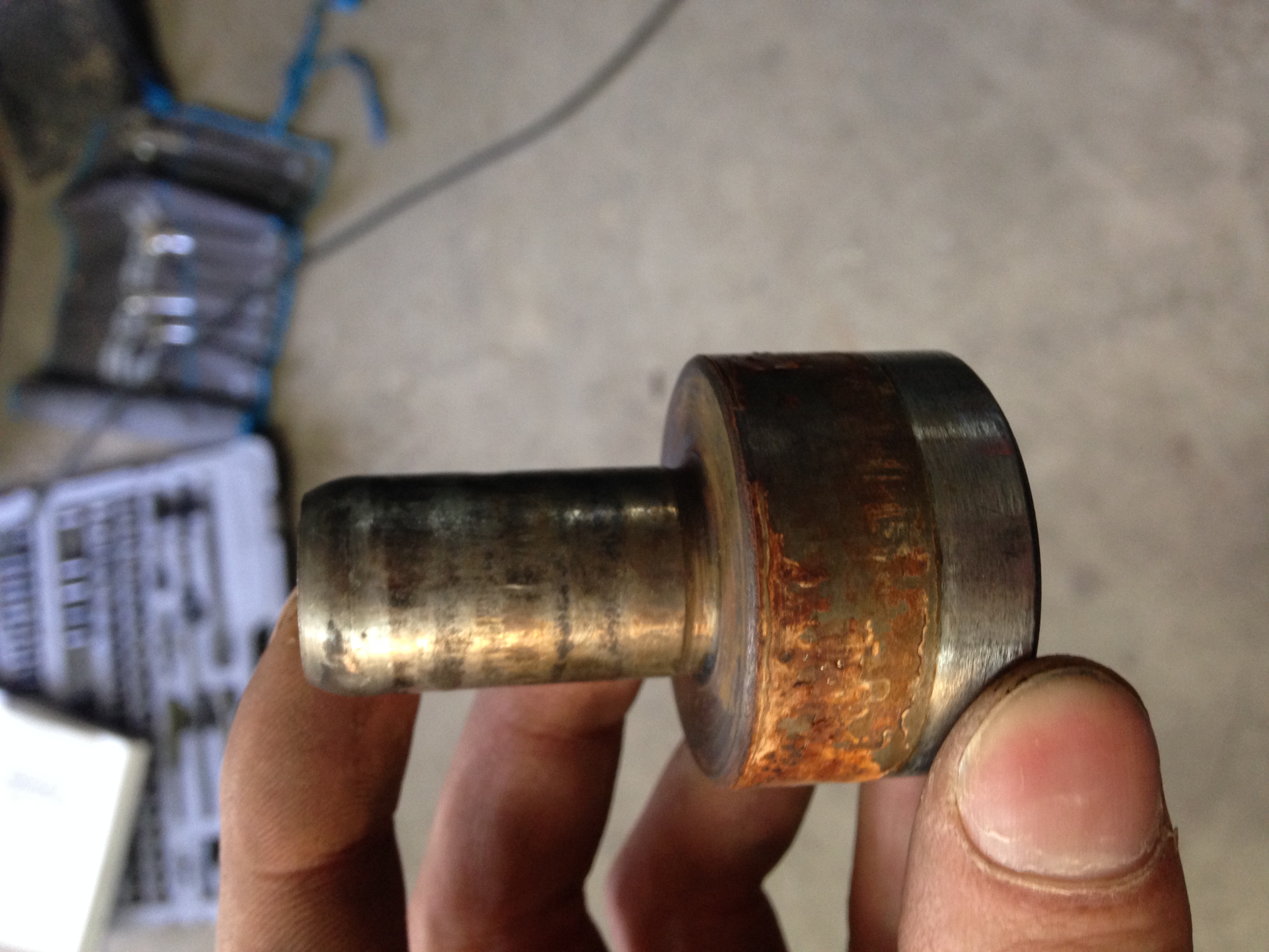

Soo.. this is where I'm at... removing the Centralizing peg. This part, I have to admit, is a robust foe. I think the blokes at the factory went locktite crazy on this thing. I have tried making a puller from a large socket, washer, and 8 125 bolt with little success. Having said that, I am terrified of breaking the bolt in the peg. Next step (tomorrow AM, after these beers wear off), make a sliding hammer and heat the hell out of the peg and bang it out. Aside from that I don't know what the hell else to do, except repeat and pray to rover gods.

A piece of tube with a thick washer and bolt and it will pull out, yes you need the spacer so you get the correct bearing pre-load once done up.

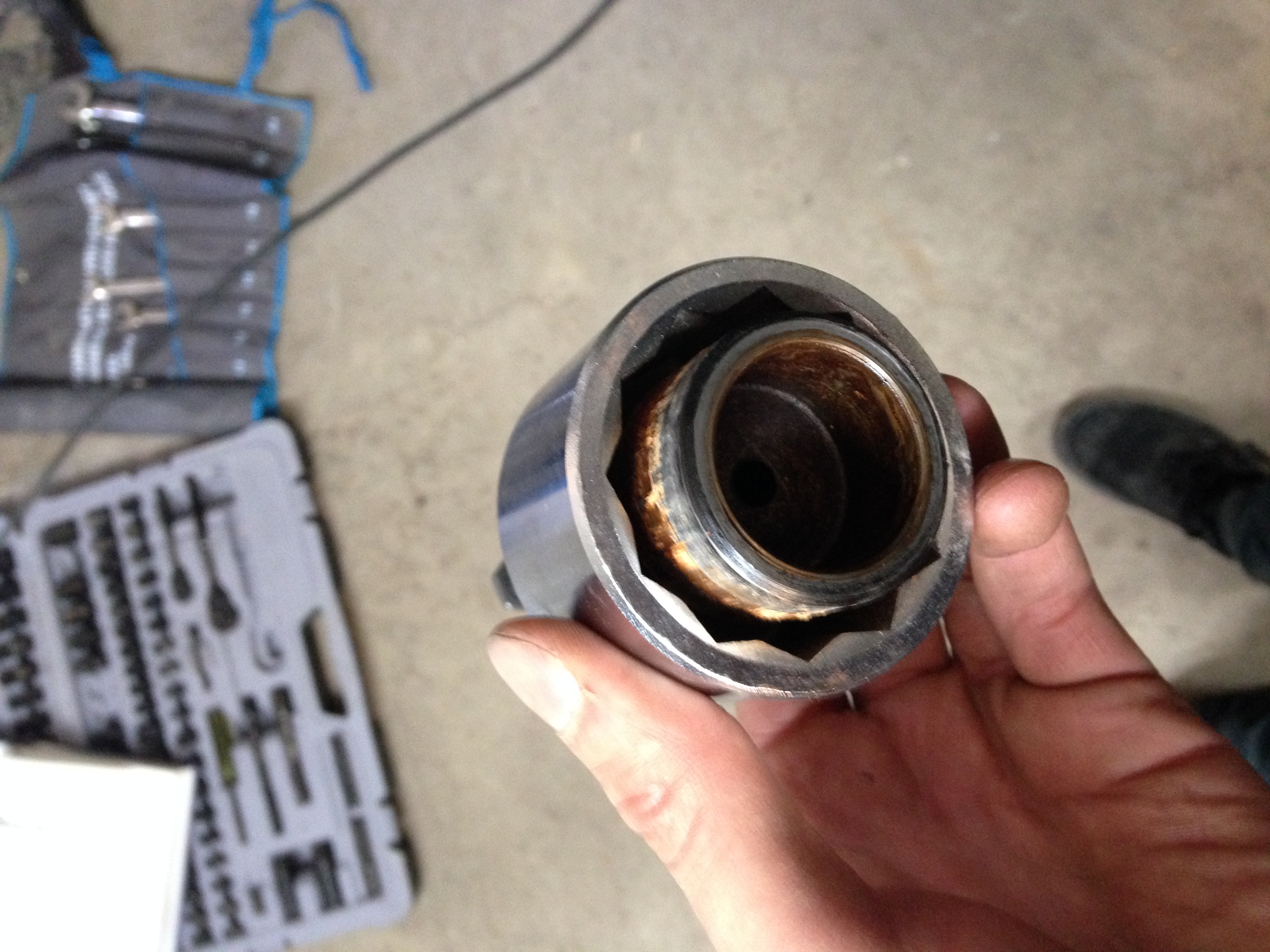

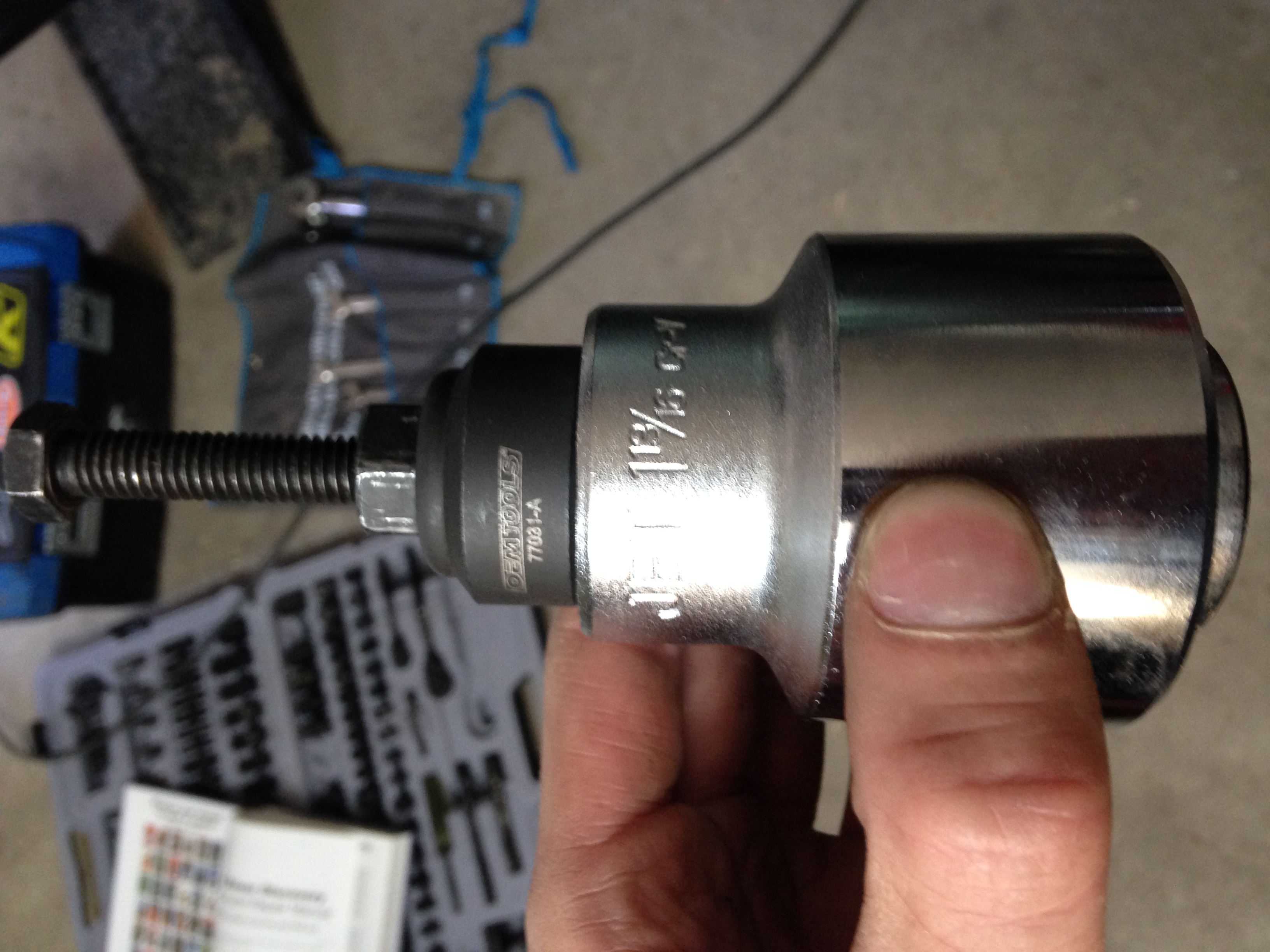

Hey Guys thanks for the input and support. So today has been a success, but definitely a wide range of frustration with this centralizing peg. I made a sliding hammer with some huge washers, big socket etc. I'll nab a pic tom. I also heated the living hell out of the thing. I thought Lord Sauron was going to emerge demanding for his damn ring back it was so hot. The heat and sliding hammer were a bust. Threading in an 8M 125 bolt through a washer and socket was a bust as well (broke the bolt, and thankfully got it out...).

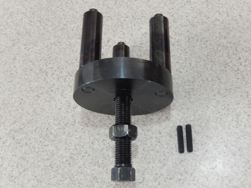

Eventually I got the bugger out with a combination of heat and a puller I created (as seen in the photo's). Both worked magnificently, I know it's late and I will update tomorrow, if there's any questions, but I essentially created my own version of the 'Land rover tool 51-008' (last picture, stupid, worth $200 odd dollars or something) with a 1 13/16 socket and a 8M puller tool with the same thread that I rented for free ('OEMTools' 77031-A).

I made a simpler tool for about a 100mm length of 50mm SHS tube with a piece of 4mm plate welded on top, drilled a 10mm hole and used a M8 bolt with a thick washer.
I was lucky with mine and it came out easily but when we put an ARB locker in my mates D2 with an early D1 uni shaft it broke my tool and we had to scrounge something to replace the plate i welded on.
