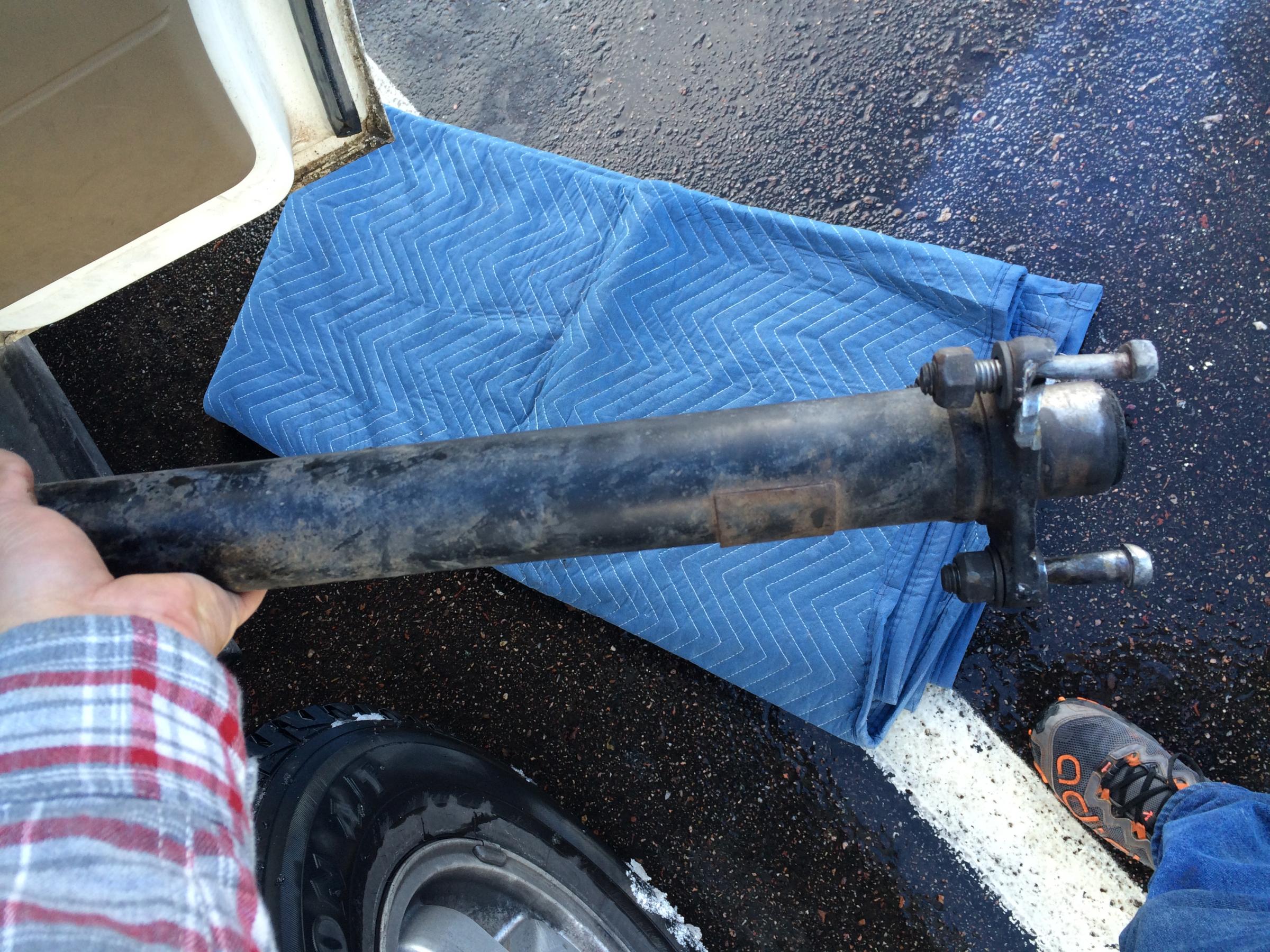

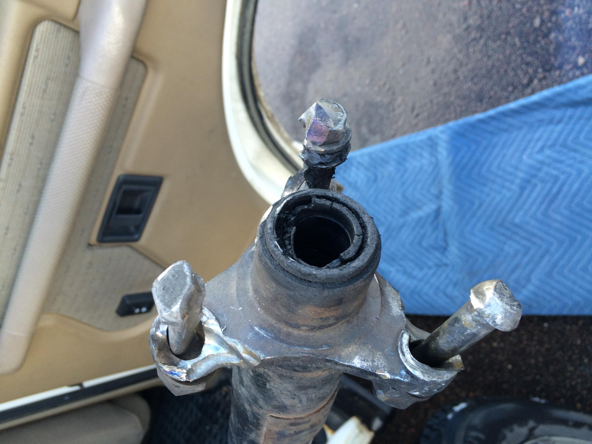

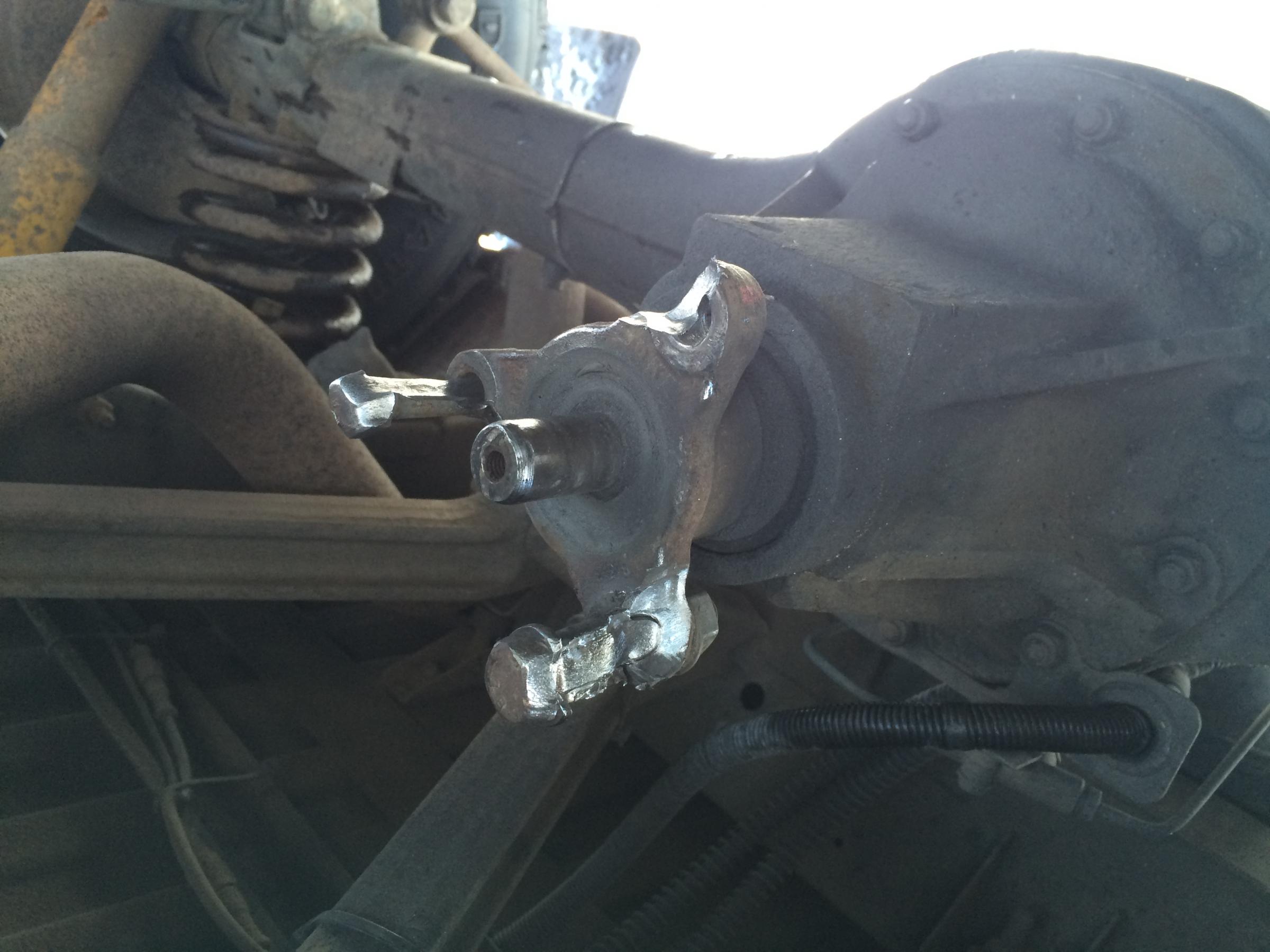

So today I was driving in the snow down a hill probably going no faster than 40mph and all of a sudden I heard a loud pop almost as if I ran something over and it hit the underside of the truck. I pulled over as far as I could off the road like I said I was driving downhill in snow so I didn't have much room on the shoulder. I looked underneath and noticed that my Rear Driveshaft had separated (missing Rotoflex Rubber piece ) from I believe its called the flange (3 bolt system). That part was lying on the ground. After coasting about 50ft I heard knocking underneath got out and looked underneath, noticed that my Rear Driveshaft was on the ground. I was able to make it to a gas station with my differential locked but only driving uphill now around 3mph with knocking.
My question now is what will need to be replaced? Will I need a new Rear Driveshaft or can I still possibly use the one that fell off? The flange (i think this is what it is called) Completely snapped and chewed the 3 bolts that was holding it in place. Obviously i'll need a new Rotoflex. Should I just get it replaced with a U-Joint instead? With the knocking sound is there now something wrong with my Transmission at this point?

I wouldn't even consider re-using that.

the knocking sound may have been the spline in photo 2(?) hitting the truck body or frame. In the photo with the spline you can see where it or the drive shaft rubbed.

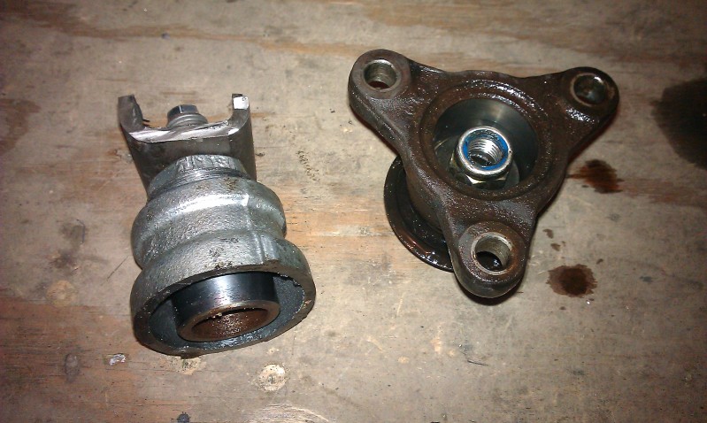

Its easy. The hardest part will be pulling the Rotoflex centering pin out of the diff. There is a special LR tool, but I made one from about $5 in parts from Home Depot.
