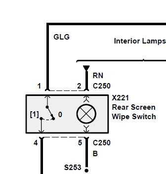

The rear wiper switch will pull directly out of the gauge surround. Literally, just pull it directly out. Then jump the wires that would otherwise be linked if the switch were 'on'. That'll tell you if it is simply the switch or some other wiring issue.

First thing I did was clean the switches but I was confused about the wires. Is it two wires do the light and two wires for the switch, I can’t remember how many wires there were I just remember knowing it had power. I suppose a multimeter could confirm continuity, I should start doing that with all the switches probably. Is there an easy way to know which pins are relevant to the lights and which are to the switch? Also, the wash switch washes but doesn’t wipe anymore…

electrical diagrams. Section F3, page 2
jump pins 1 & 4
Attached Thumbnails rear wiper not switching on, other wiring questions-switch.jpg
