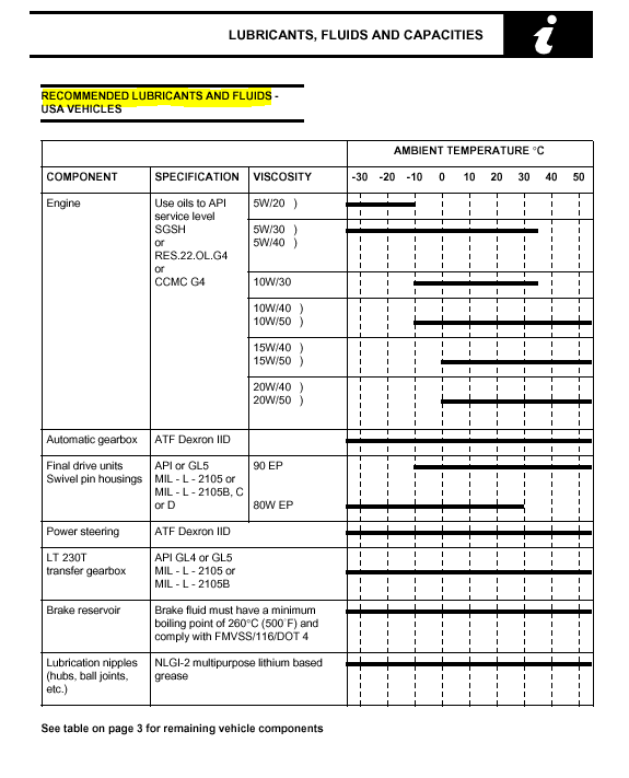

Brake Fluid: CASTROL GTLMA DOT 4
P.S. Fluid: CASTROL ATF Transmax
I'm NOT a fan of "mechanic in a can" fixes, with that said I've seen AT-205 Reseal work.
Good Luck!
