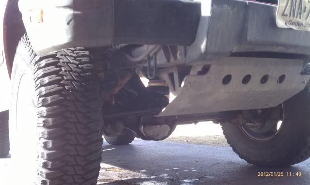

Easy as pie
With these though you'll have to trim your bumper or the first time you use it the strap will most likely break the lower part of your bumper.

Looks like the Jate rings are mounted via a tube welded onto the frame. Doesn't even go through the frame. Seems pretty easy to tear off.

Apparently there are multiple designs and makes of JATE rings on the market. Again you have to be careful that what you do buy is well made and that the attachment method is robust to avoid failure.

These look more prone to failure since there are more points that could come apart.

Jate Rings
Look at the mounting pics. Those look about as strong as the factory tie downs.
I'm not trying to bash them, I just don't thing the mounting points are near as strong as they would like us to think they are.
