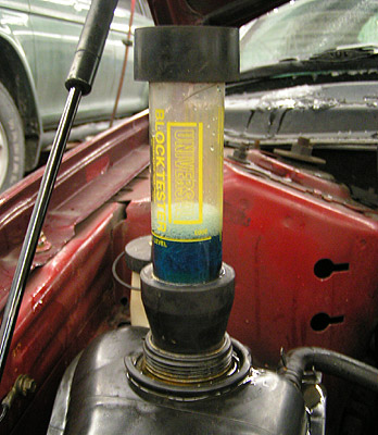

The mayo in the oil is one thing. Have mechanic or yourself do an exhaust gas in coolant test (changes color). White smoke out the exhaust once truck warmed up is another, which you haven't mentioned.
