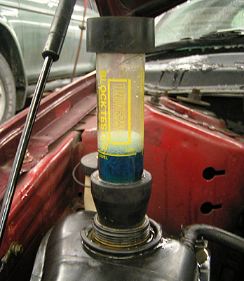

Now, with that definition - how long can your drive the truck in traffic before the gauge or scanner indicates high temperature - above 218 or above 50%? If you can drive on the interstate for an hour, or around town in stop and go traffic for a couple of hours, and gauge stays normal, you would want to have other indicators that it was a head gasket. Those might include - loss of coolant, white smoke out the exhaust, coolant in oil (makes a milkshake), misfires and check engine light on., bubble sounds under the dash. There is a chemical test you or mechanic can do that sniffs the hot coolant for products of combustion and changes color.

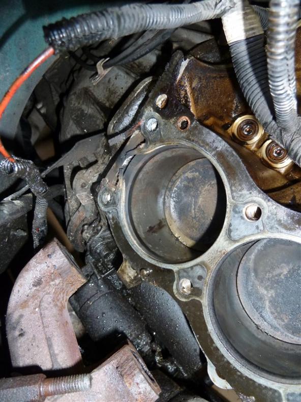

The head gasket is weak enough to start with. Driving around with low coolant and overheating will stress it more and it will fail. The most common failure is around the water ports, fore and aft, where it is thin. See pix of one failed both internal and external.
Now can you have more than one problem with a Rover at the same time? Yes, sad but true.
