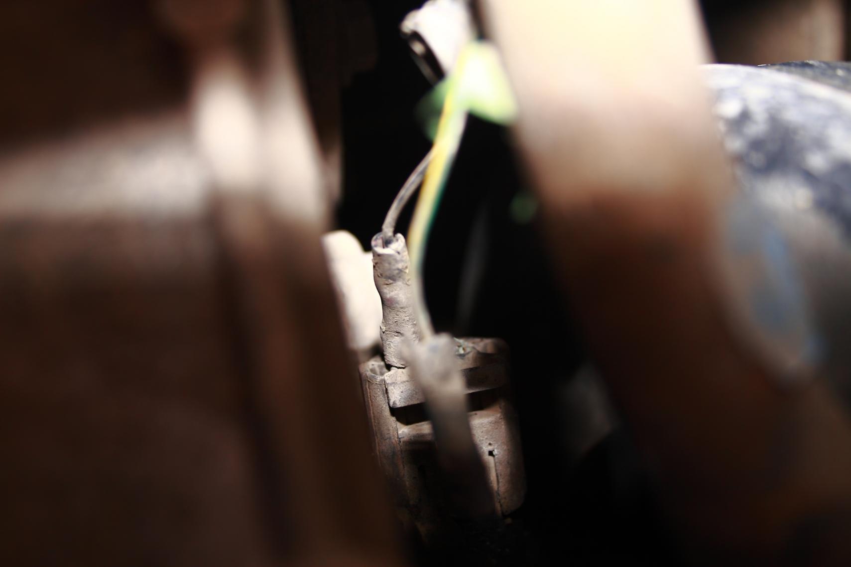

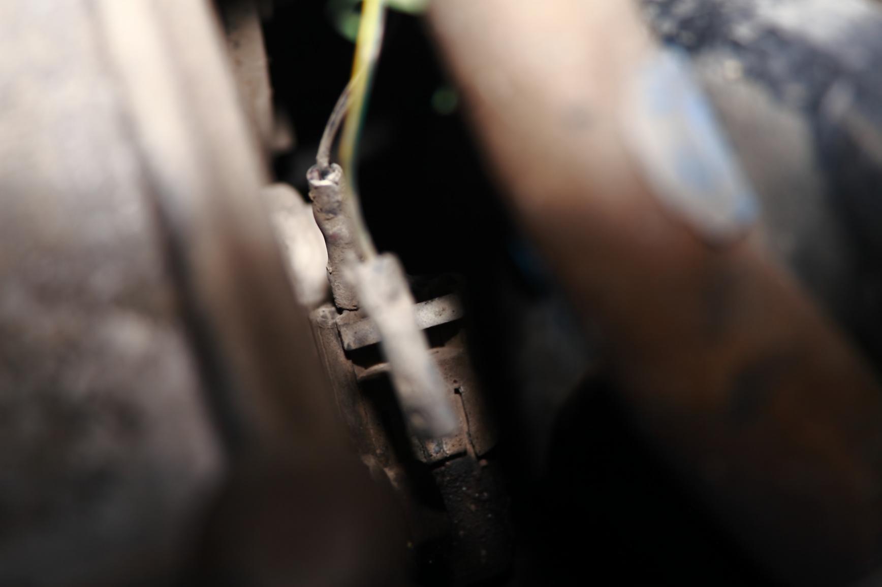

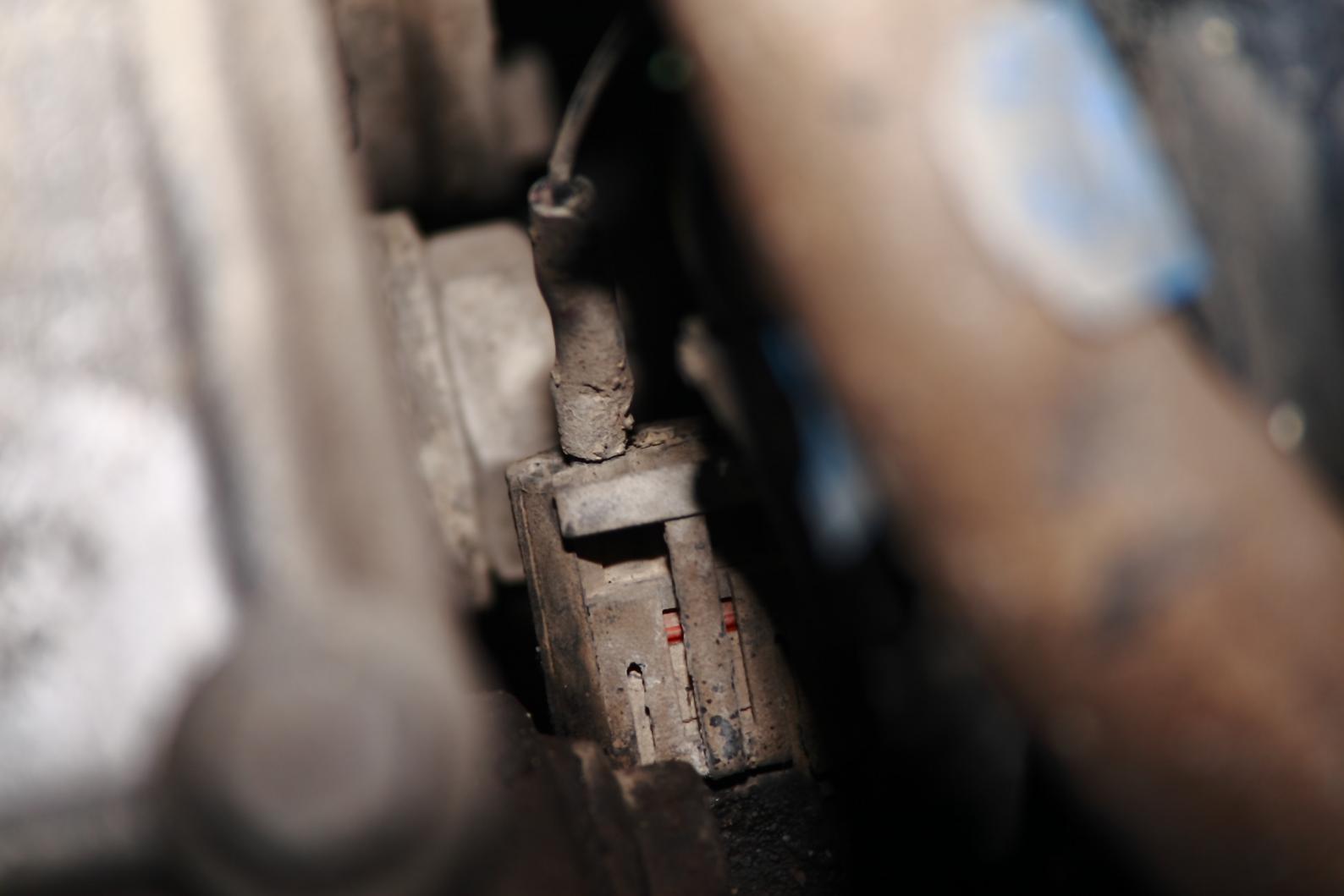

Hey Montana, can you take a pic of the offending plug and broken wires?

Here are the photos of the broken / disconnected wires and plug. Hope this helps. Thanks

Pull the harness off the sensor, and see what type of connectors are in there. I have had mine off, but can not remember. Maybe they're a standard type, like a blade connector. Then you could cut the harness off, put a matching connector on each wire, and plug each one on seperatly. Hope that makes sense.
Otherwise, I would be calling junk yards, asking for the harness and as much of the wire with it they could get.
