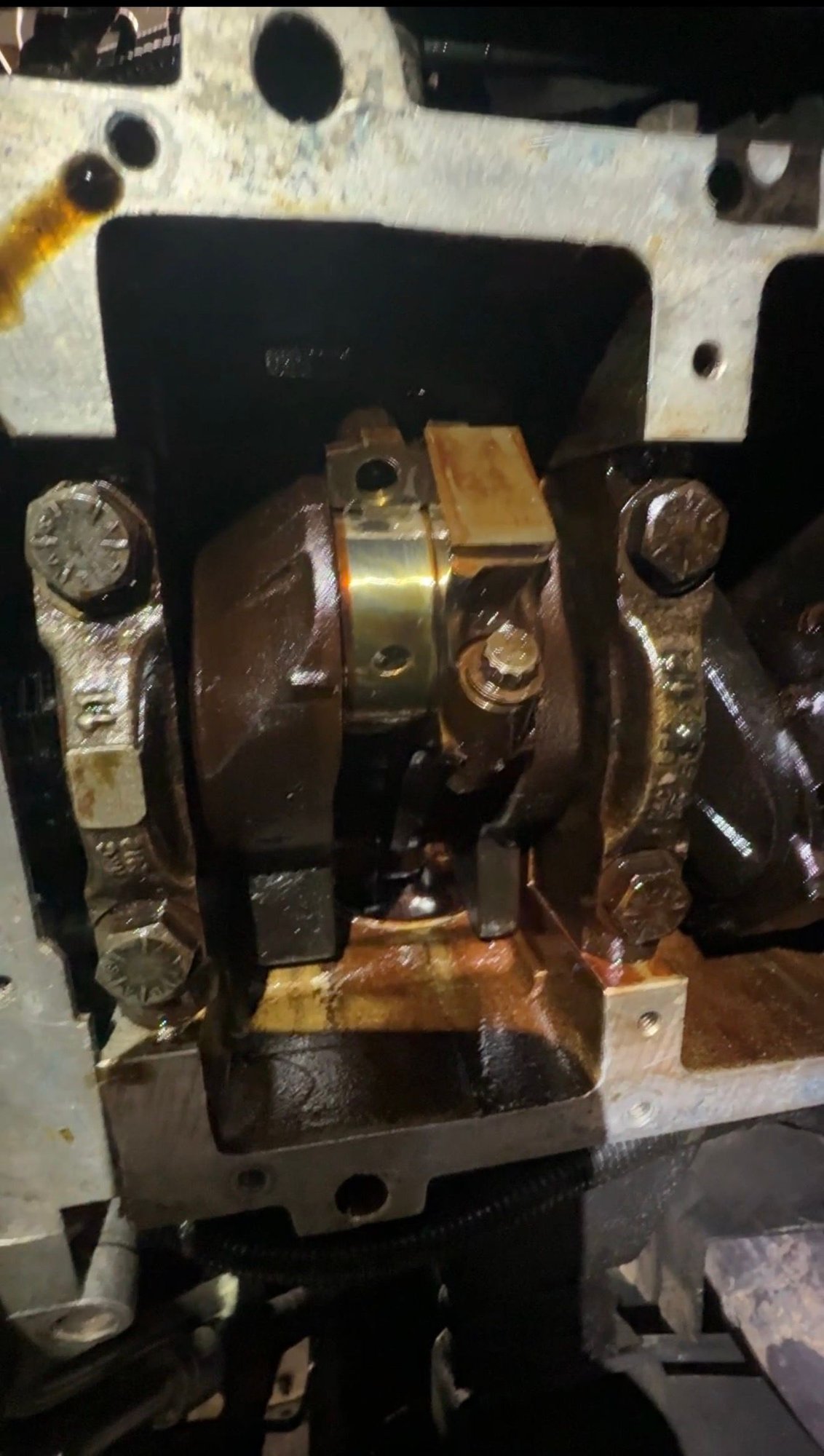

Guys, i'm working on the rod bearings now, changing them all. I got a question about torque ratings. I know that book says "Fit bearing cap bolts and tighten to 20 Nm (15 lbf.ft) then a further 80 degrees.". Now 80 degrees isn't as easy as 90 degrees to mark...by any chance, maybe someone actually has final torque value for those cap bolts?
