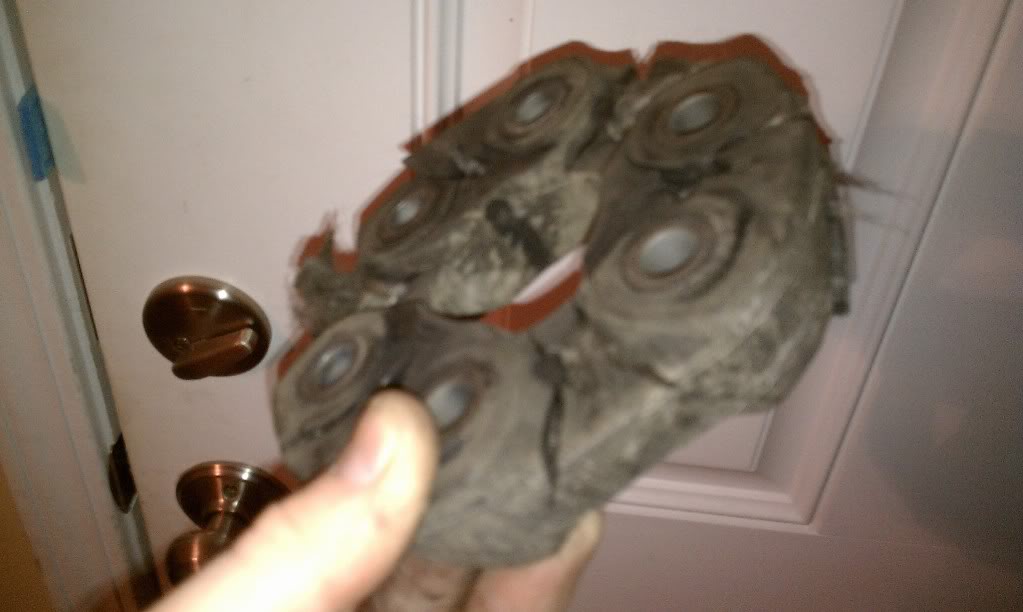

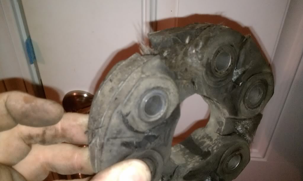

I replaced my rotoflex last year, started getting vibration again, looked yesterday and its totally shot. It's literally being held together by the strings. The one I used was an allmakes, is there a distinct difference in quality between the original and aftermarket rotoflexes?

AB listing says genuine part, $109 - and you paid how much from where?

Generally ALLMAKES is cheap off-shore. You gets what you pays for!

Old Mar 28, 2012 | 05:46 AM
tweakrover's Avatar
Joined: May 2009
Posts: 1,348
From: North Carolina Coast

It is possible to install the rotoflex incorrectly, but I've heard that some cheap rotoflexes don't last very long.

You definitely can install the RotoFlex incorrectly. And I have heard that some are inferior construction.
