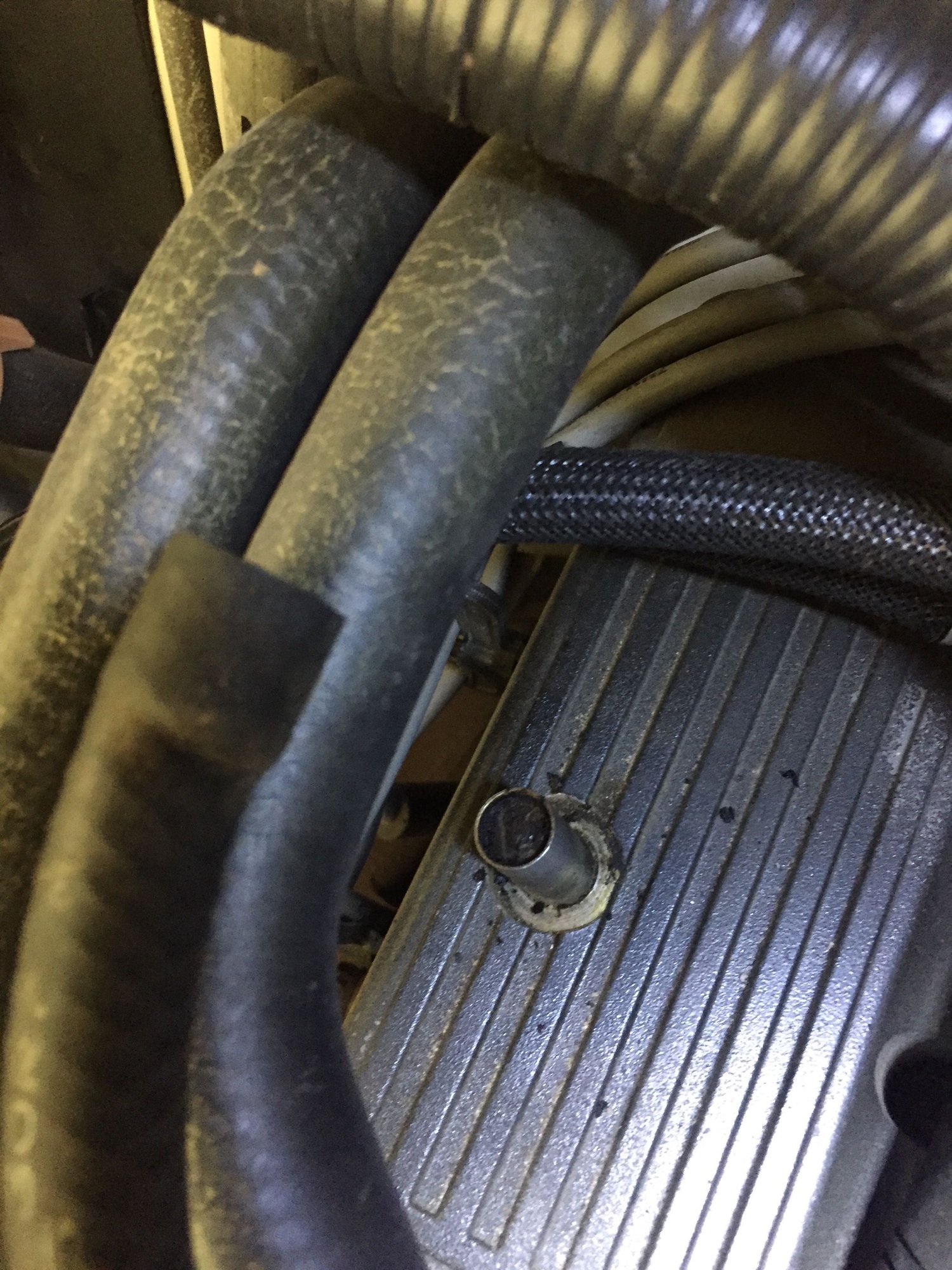

In trying to trouble shoot the PCV for vacuum issues I pulled this hose and found this. It seems to me like the oil separator here is completely fouled and needs replacing.
Thoughts?

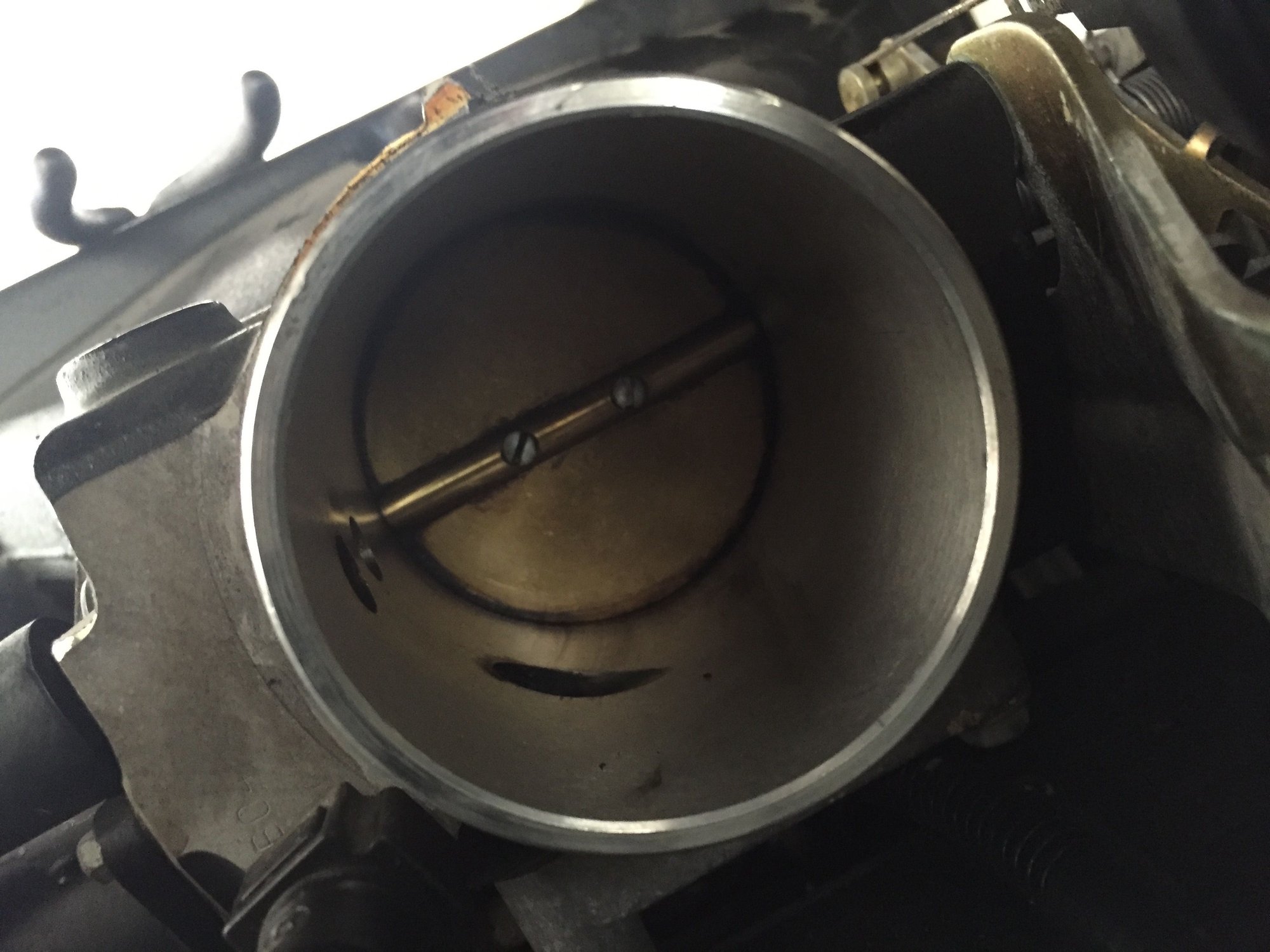

Here is a shot of the throttle body after cleaning.

if u can get the oil separator out without breaking it....it can usually be cleaned
,and did you clean the IAC ?? when you were cleaning the throttle body ?
