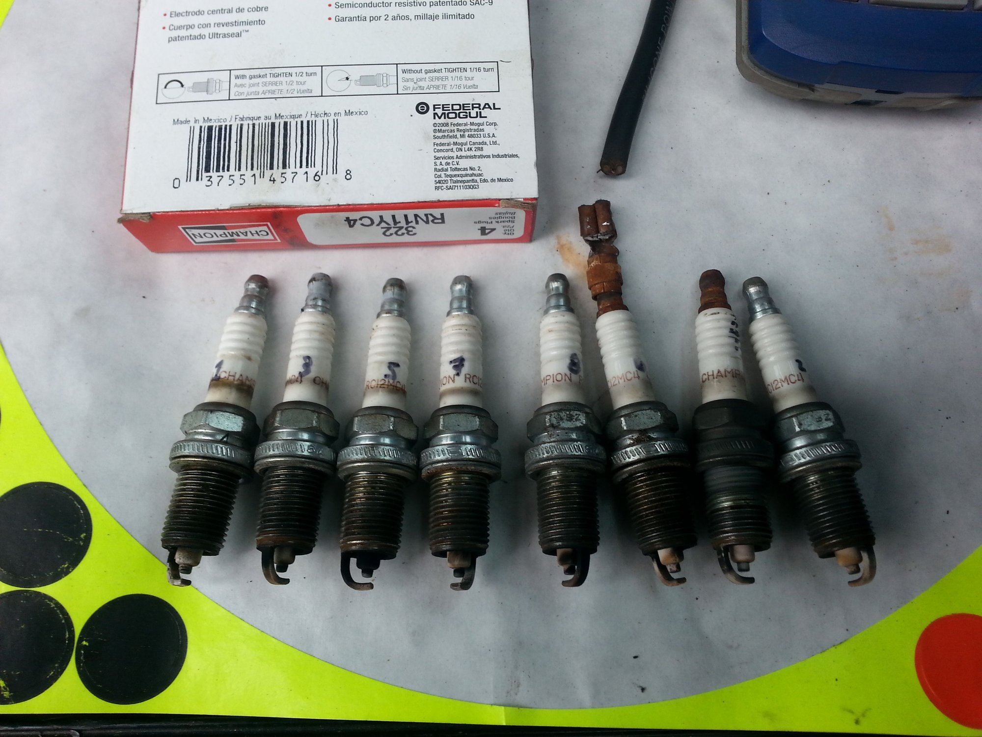

Changed plugs and wires. Went with basic, cheap Champions. Found two plugs that where rusty as hell. #6 wire is shown. Core was way up in insulation.
6 out of 8 ain't too bad. :-)
Running great since. Got 16+ mpg last tank. :-D

Looks like they were very much due......
Running funny, nothing new on my end, mine thinks it's Sam Kinison most days....

And the gap was about .048 each.

I started at 8AM this morning looking for a wire set locally, just finished up plug wires and sparklers while dead tired from long work week. Made my own wires (both ends) for $30 from NAPA, carbon core (not my first choice). They had wire core but only in 6 cylinder wire sets. Cleaned MAF too. My last tank I took a big hit under 200 miles, lowest I've ever let the motor condition take it down. Normal is 350+ miles per tank. Took me rest of day to get it just right. No more cash out the tailpipe and the idle came down to 675 instead of 1100. These ECU's can make up for allot of slop to keep the motor running. Four wires shot, fireworks show. The others had faint leaks you could see in the dark. Plug gaps at .40 which wasn't bad but over 30k on em after a couple of re-gaps, round center electrodes. Took the truck out for a short blow out and definitely working on all cylinders, hit 70 in no time. Just cheap ol Champions and 7mm make your own wires, not bad. Beat. Gonna eat, watch a movie and sleep in tomorrow.
