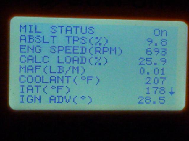

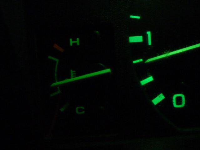

After all the fluid changes today the gf and I went wheeling and exploring on some fire roads. After driving up the rough gravel mountain road for about a mile or two I noticed the temp gauge was high, just below the top white mark. The ultragauge said 219 F. It usually hangs around 170-190 depending on the load in town with a 180 F thermostat. It immediately cooled off after hitting flat ground or downhill. Is this normal? I really don't want to damage it after all this work.

Mine levels off, around 220*F or so it will hold pretty steady, turn the a/c off and the a/c fans stay on (like they should when in a overheat situation) and once they shut off I turn the a/c back on.

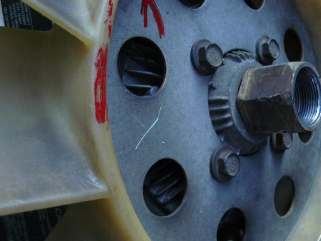

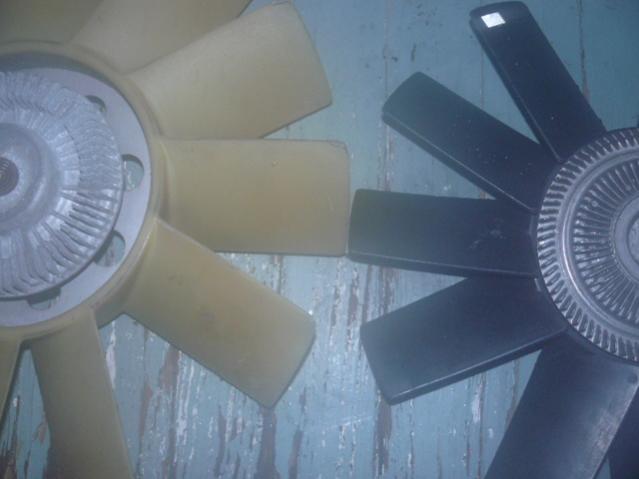

Trust the Ultra Gauge. My dash gauge says 9:00 up to 235 or so. Your 180 stat will start to crack open at 180, and in another 15 - 20 F, be 100% open. Beyond that, it is just air flow and radiator function.
1. Have you had radiator flushed and rodded out during this project? And fan clutch is easy.
2. Might try some water wetter, it does help a few degrees.
3. You can increase the size of fan and fan clutch to push more air through rad when truck is moving slow at high RPMs. I paid I think $19 for one from a 2001 Blazer. Screws right to our water pump. Makes 6 - 10 F change in summer when I am at 100 F outside. I don't have any mountains or hills around here.
4. If you ever have to do another water pump, that new aftermarket one with the larger brass impeller will move more coolant.
