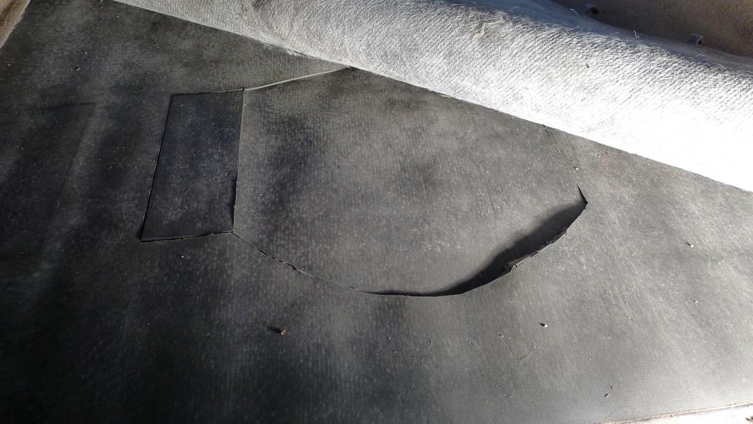

Not trusting the reading, I decided to lift the cargo carpet and begin the arduous task of prepping a for a new fuel pump or fuel assembly. to my surprise I found this:

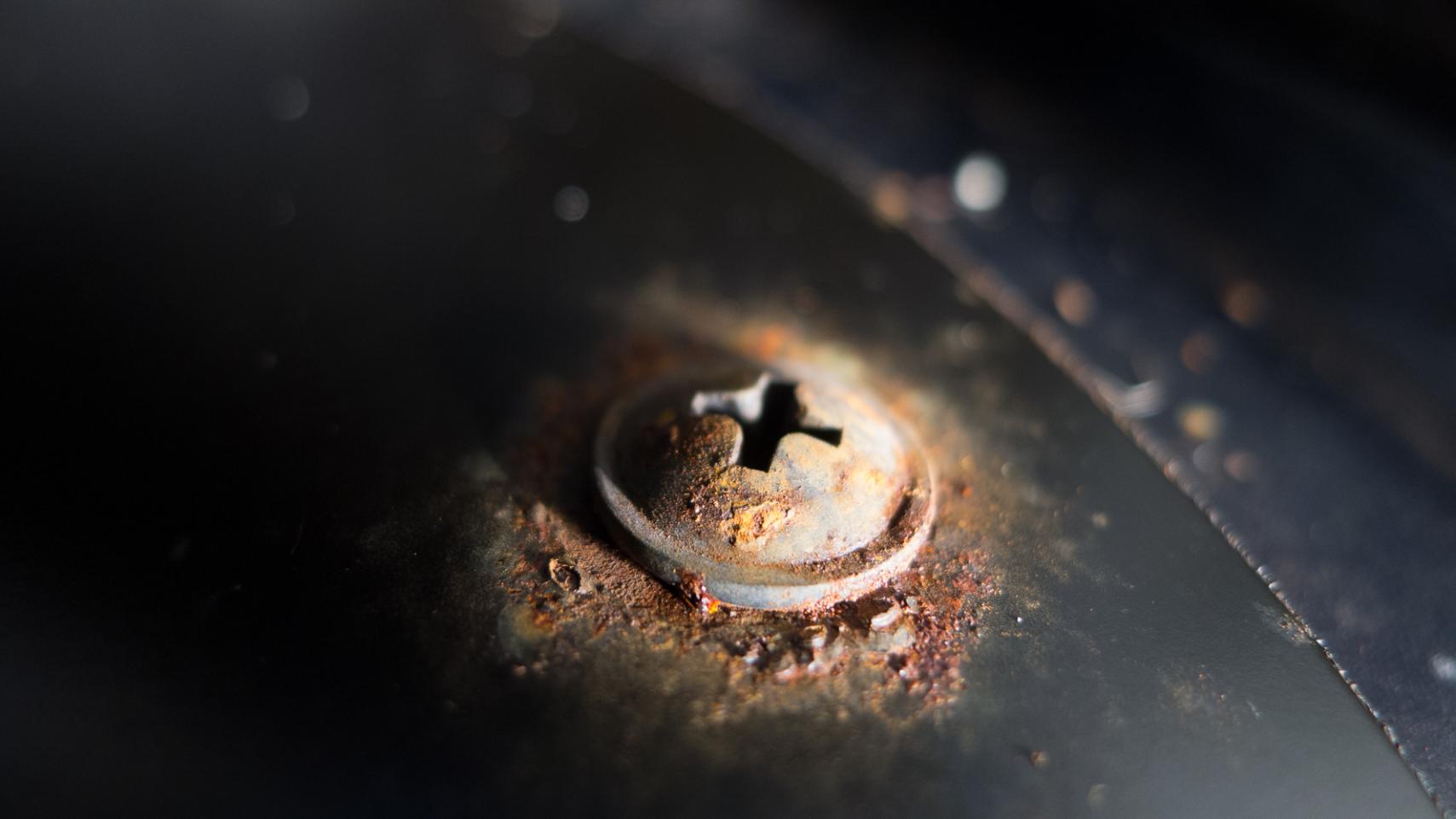

THe only rust was around the screws.

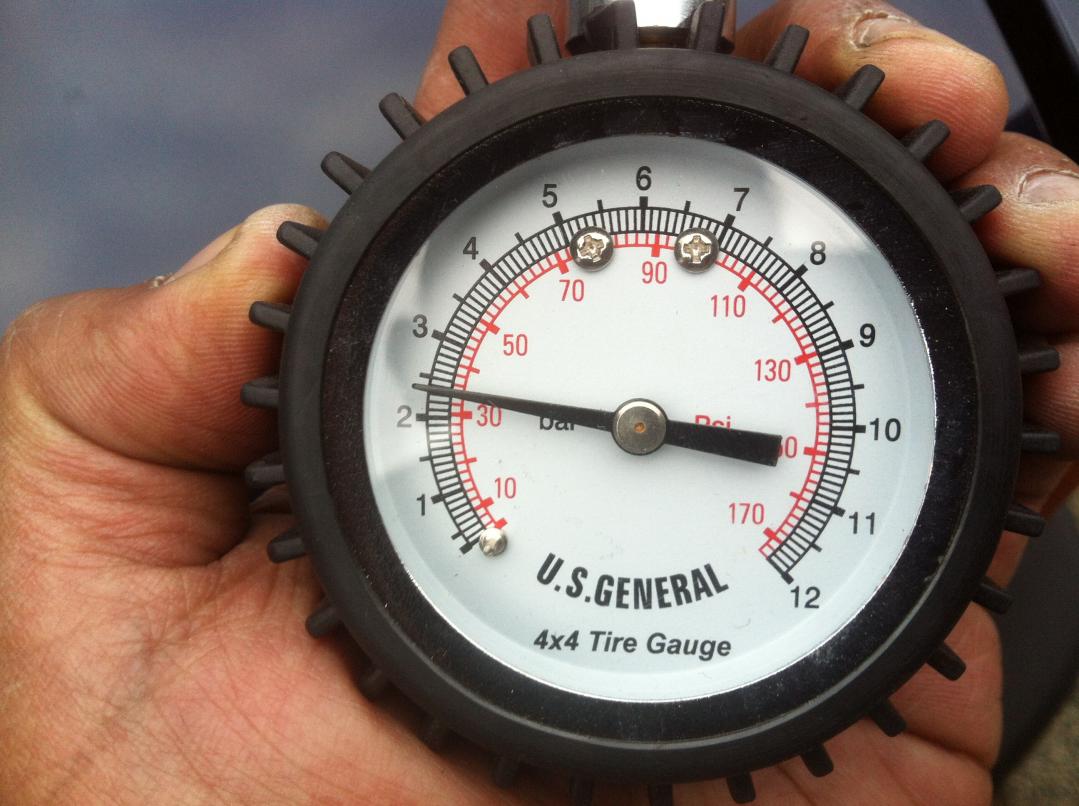

Today, I bought a tire pressure gauge, yes, Harbor Freight—whatever, it was $6. This time I wanted to test against the initial full tank reading.
I had less than half a tank—approaching a quarter maybe at a quater of fuel (again, feeling the car running a little rough).
This tire gauge confirmed an acceptable psi, albeit, two different instrument-type readings. Yet, I'm almost confident I'll get the same reading with the tire gauge at a full tank. This would naturally lead me to hypothesize the fuel pressure is good and the pump runs fine.
