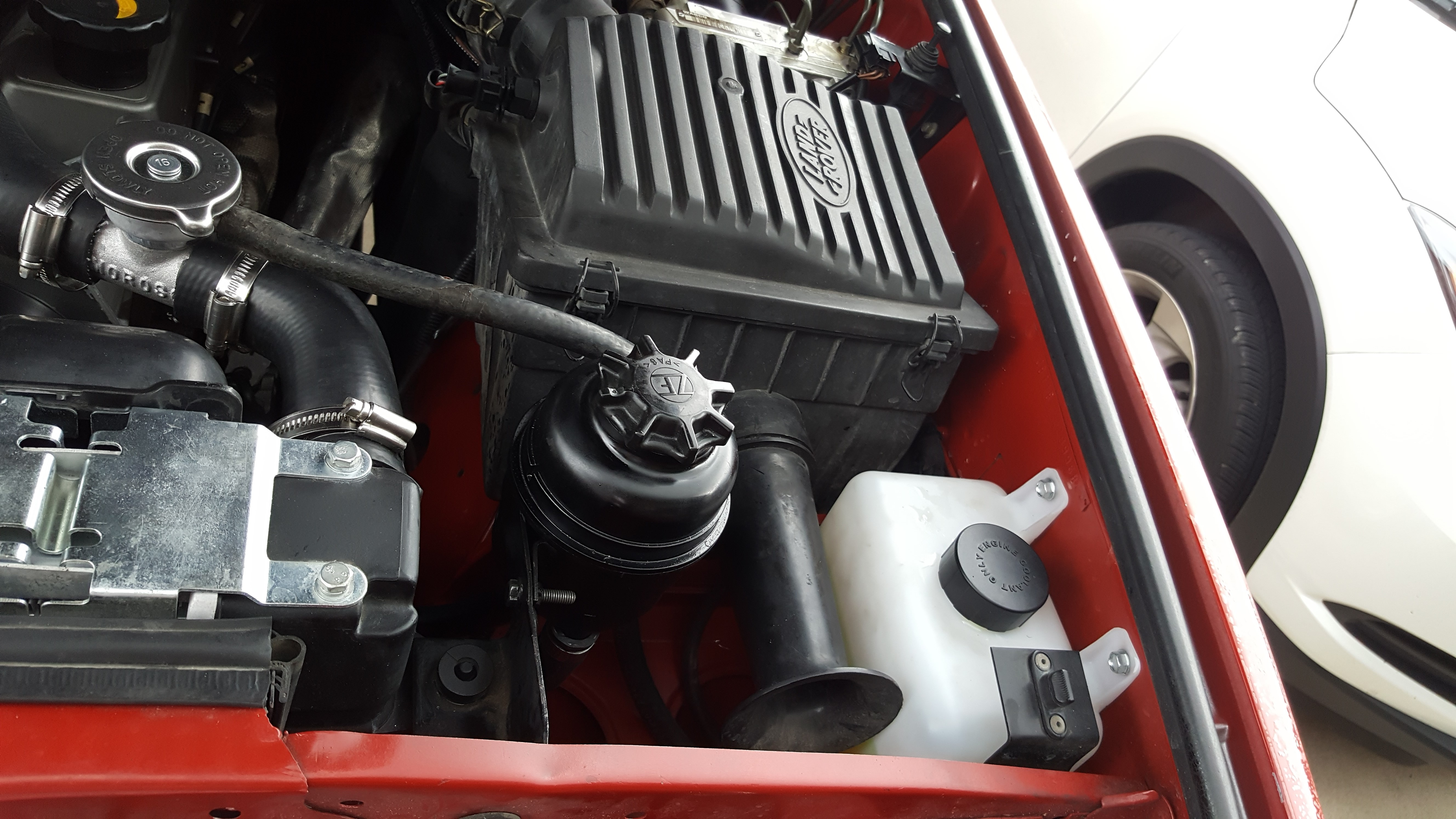

I should add, I do not have a 100% stock cooling system. Most everything is the same except the overflow. I converted to a more traditional style with a fill cap and overflow bottle. See picture below.
