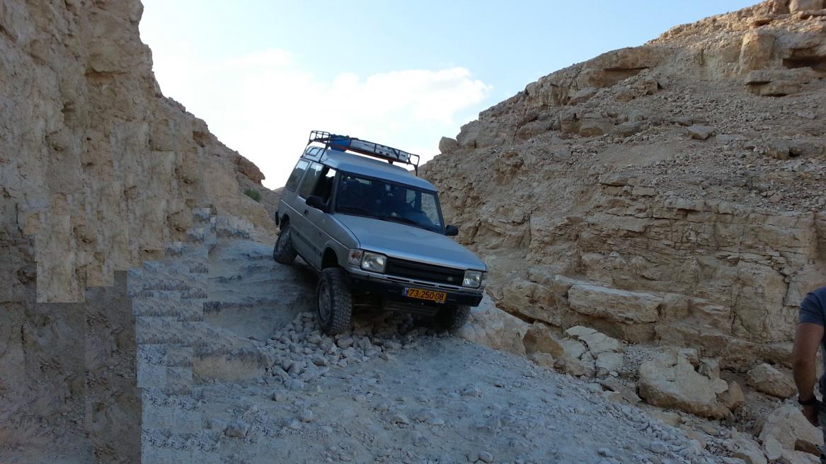

Cool photo. Looks like there are some good off roading areas in Israel.

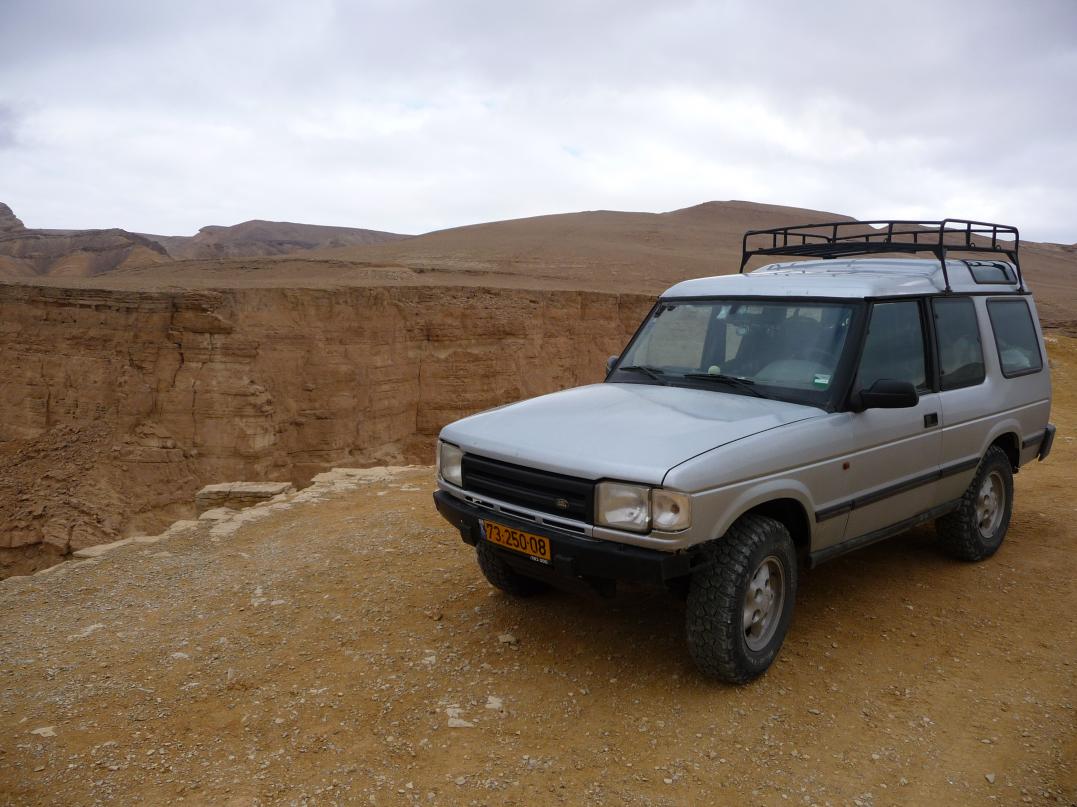

thanx wkburns,
yah we have an awsome desert to explore with alot of elements..
