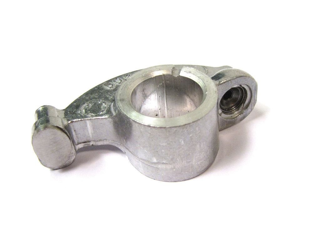

Did you check the rocker arm cups?

these are steel rockers, doesn’t seem to be a cup, but rather seems to be one piece.

The rocker arms have cups in them on the push rod side with a hole in the center for oil to pass thru and lube the push rod. They can come loose and rattle and it'll sound like a bad lifter. You check them by inserting a small tweaker flathead and if they wiggle at all = bad. They cup should not move or wiggle.
im not doubting you, but it seems very seamless if they do have separate cups on the steel ones. Regardless, they’re new after the fact anyways.

Being new is honestly what concerns me. Nothing made these days from China for our LR's seems to be worth a darn. The cup with the hole in it is what can "float" and cause noise.
