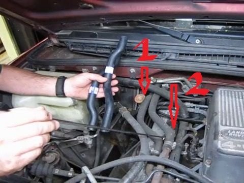

In the pic #1 heater hose(LEFT) is routed to the manifold through small hose PEH101530(it different diameter ends). The #2 hose(RIGHT) is fed from the lower radiator hose.
