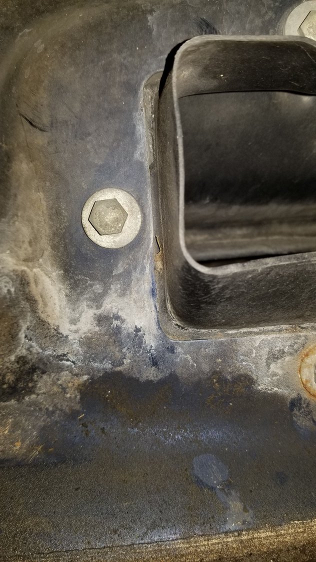

This looks like the culprit. Deep water on cowl would get to it.. what do you all think?

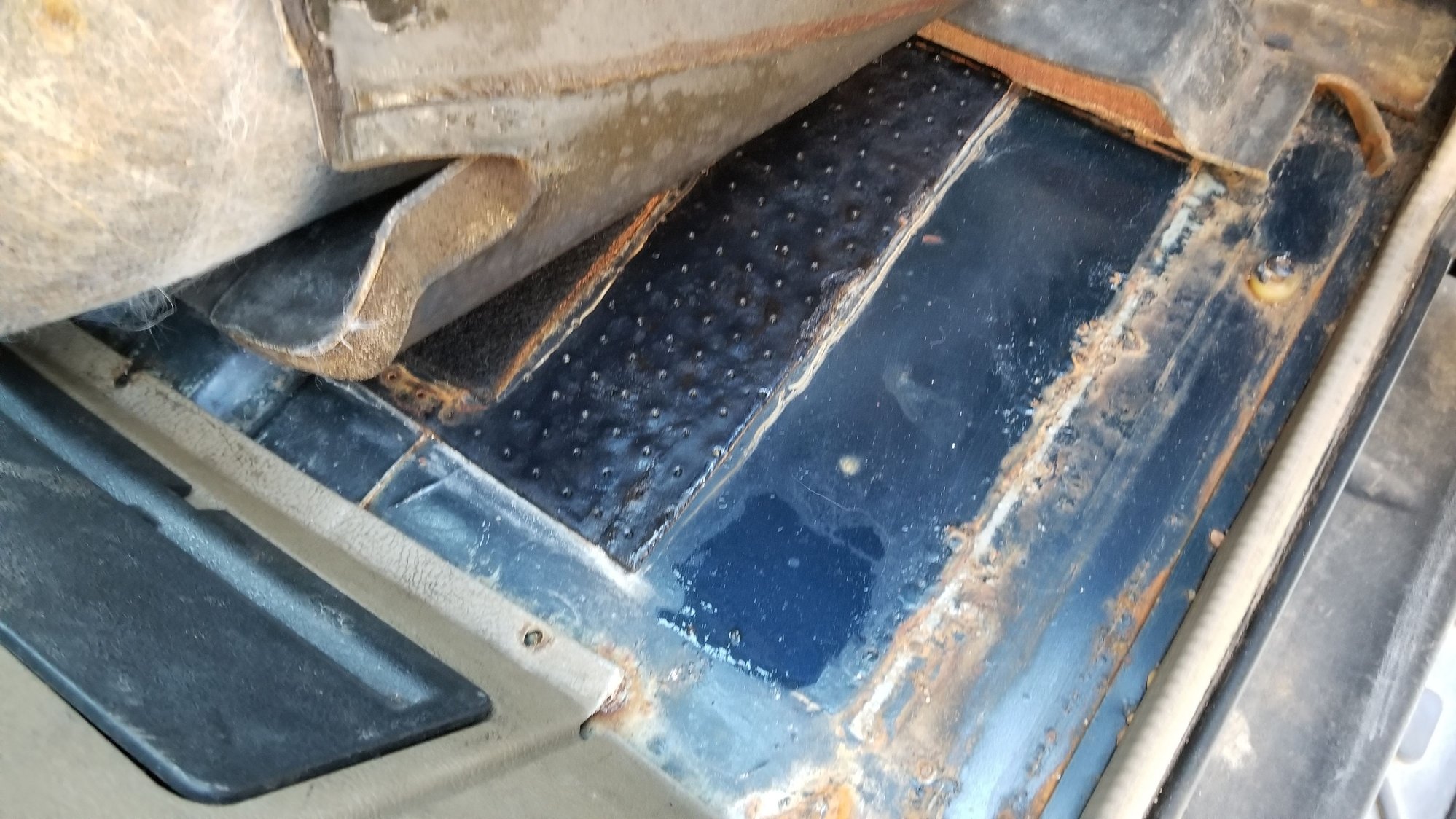

Hey-- quick question for someone who has had water on the passenger side floor.. I have sealed what I think was the cause, confirmed that both drains are clear, and I think that any water from the sunroof corner drain would be clearly seen coming from the A pillar.... AND I have ran a heater for several hours on that floor under the mat - left it open in the sun for more hours - till it was all dry
So when there has been no rain and the "sponge" of the floor insulation material still seeps water like the spot in the photo, Am I just seeing residue of the moisture in the sponge-like material that may take weeks to get out? or am I still getting water from ... well - no rain so it would have to be the AC ...
Ideas?
Old Nov 23, 2018 | 02:01 PM
WaltNYC's Avatar
Joined: Mar 2010
Posts: 2,787
Likes: 628
From: NYC
That spot seems to be too far toward the rear of the car to be anything but residual wetness.

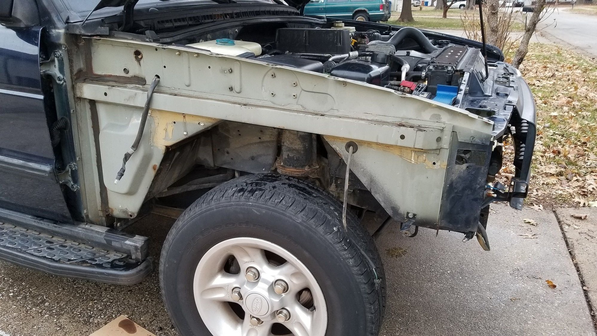

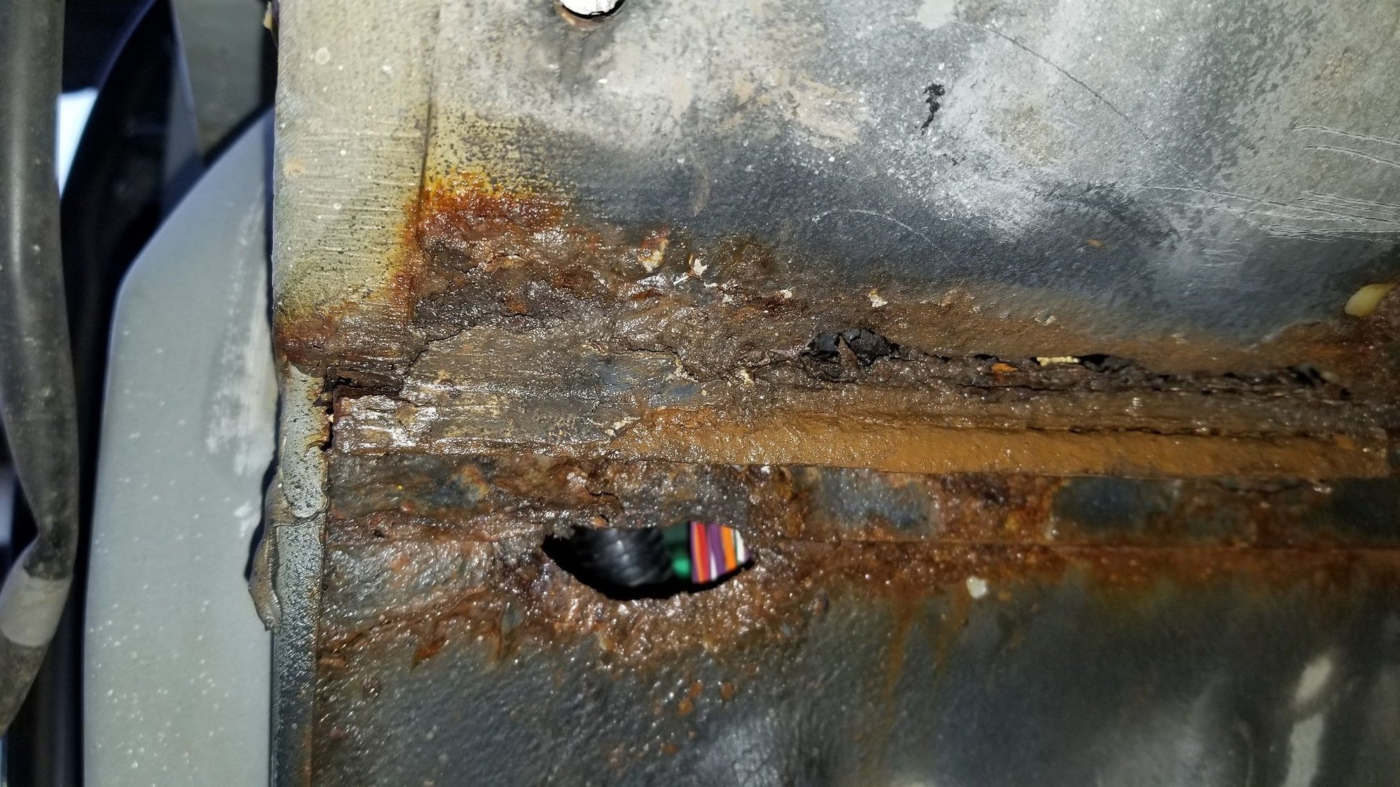

Found it.. Thanks Icannap1. I had already removed stuff but could not tell the source till a small trickle pointed the way.
Now to clean it and try out some eastwood 2k epoxy primer in a spray can (if I can find it locally) and then bondo.. This will be my testing ground b4 I start to work on the back door piller rust.
I have to say the fender was more of a bitch than I thought it was gonna be. Anyone know what that gummy stuff is that they used to seal the rear edge of the fender where the 10mm bolts were? I assume it is best to use somthing when I put it back together - right?
rust holes above and below the seal line
