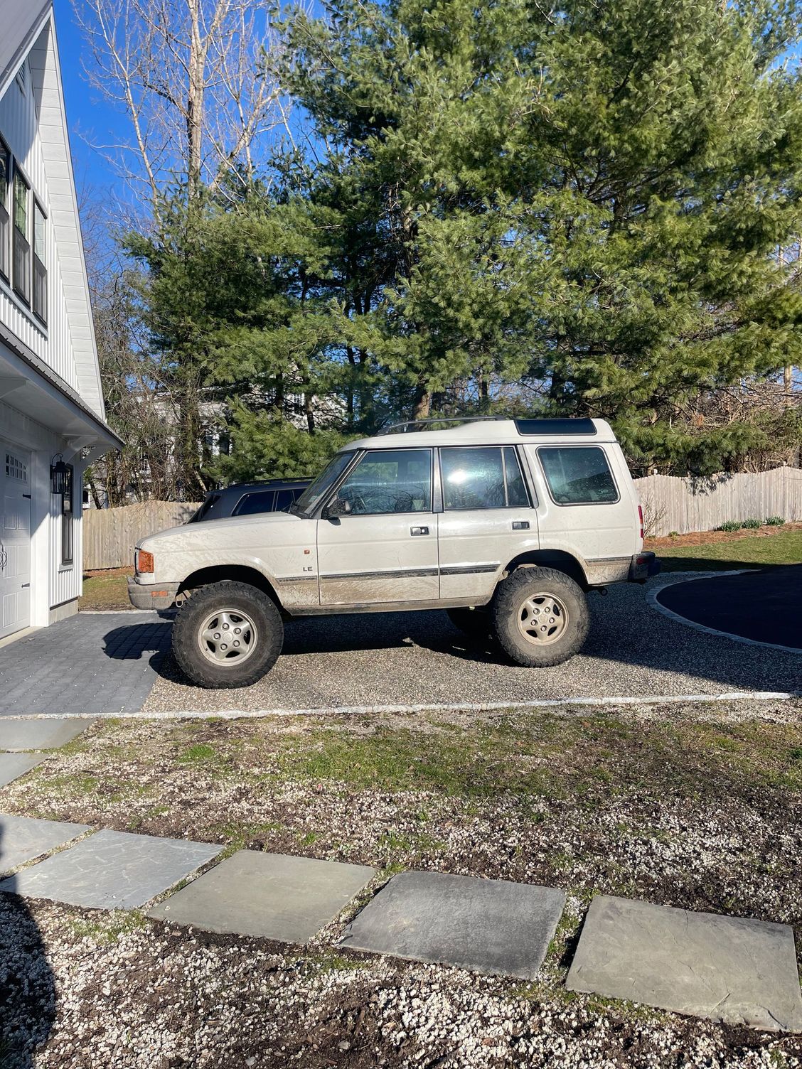

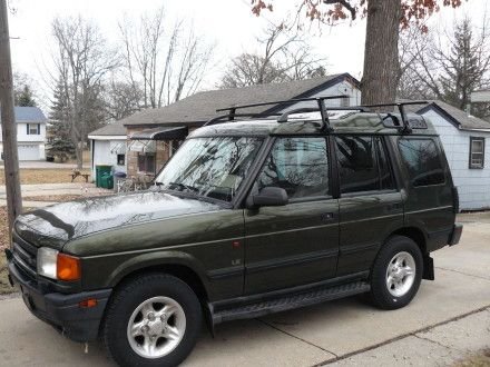

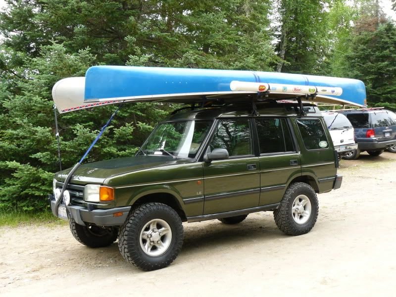

Go with a 2” lift and 235/85 or 265/75 tires. Very minimal modification required, looks clean, and very capable. Same truck at various heights.
Totally stock
2” OME lift with 265/75/16 Duratracs
3-1/2”ish RTE springs/Fox shocks lift with 315/75/16 KM2’s

fishEH, Great photos of the evolution you've managed. Nice beefy & aggressive stance in the end. Curious about the bumpers that you've added on; any info/photos you could share?

The bumpers and roof rack are RockStar Fab. They were based out of Crown Point, Indiana. Unfortunately they are no longer in the business. It’s too bad really because they were incredibly sleek and bombproof. The roof rack is actually made from DOM and serves as a slider if you tip into a wall or rock.
